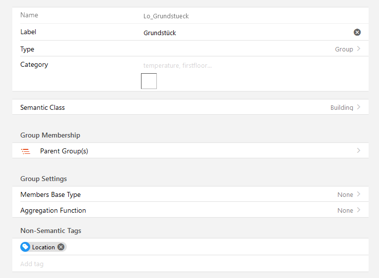

This is how one of my first level locations are defined:

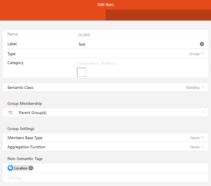

Even if I create a new location, it is not displayed.
The item exists:
but it is not displayed in the model.

Are you adding the Location tag manually when you create the item? That’s also a reserved semantic tag, and having both on the item is quite likely the cause the loop because Building is a sub tag of Location.

No. I only use “create points from thing”.
