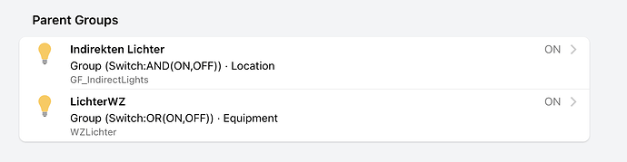

I only started now to work on my health checks and I get a lot of these complaining my item “belongs to multiple equipments:
The item belongs to
and these are defined

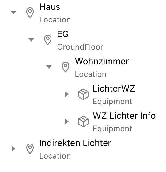

To me this is a pretty helpful structure as the item (in this case a light) belongs to the Wohnzimmer (living room) and it is also part of the Indirect Lights, which allows me to send ON/OFF to these groups separately. So, would be the solution to remove “Location” (I tried “equipment” first but it reveals the same problem) from the indirect lights?
@Mherwege AFAIK as you implemented it: I am aware that my indirect lights are not a physical location per se (you could imagine them to be a sub group of all lights of the living room, so it is indeed somewhat a physical location but I do not want to model it that way).
I feel that this leads to a broken window effect because it creates more than 20 health entries on my system which will make me overlook the real warnings. Therefore, I wonder if this warning is actually helping us or rather confusing? Maybe filtering types of health checks could be a solution but makes it even more complex…WDYT?
You need to change your „indirekte Lichter“ group to be a non semantic group.
It will therefore not be shown in the semantic model tree, but keeps the functionality.
Ok, by removing “Equipment” or “Location” and setting it to “None”.
Yes, remove the semantig tags for that group completely.
