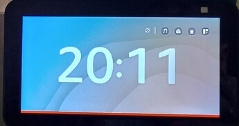

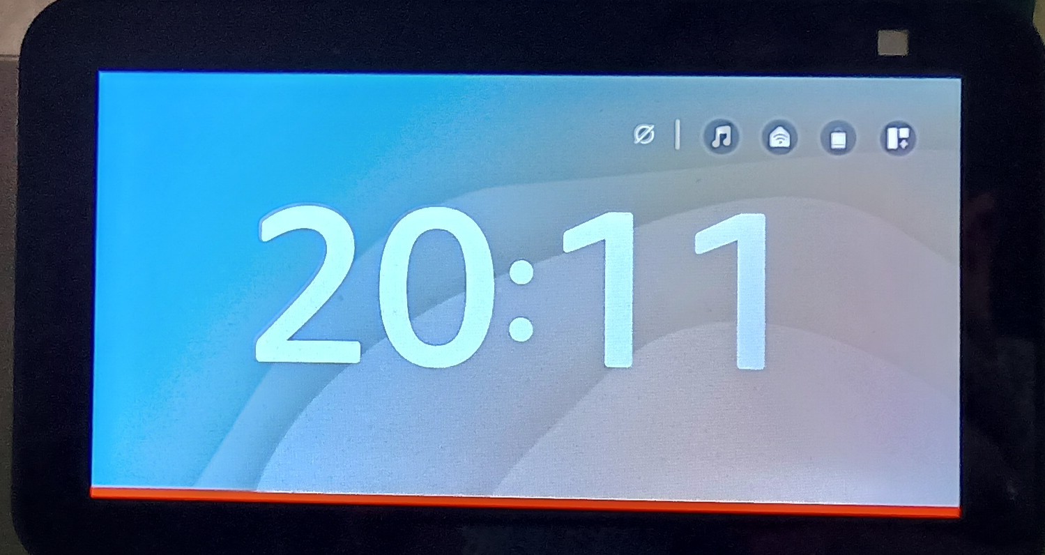

I use an Echo Show. You can turn off the screen and change/cancel next alarms with voice commands. I am not sure if a changed alarm time could be sent to OpenHAB to make the system aware.
Same here. Echo Show 5.
Automatic display dimming. Lowest setting does not disturb sleep.
Never need to find a physical button again.
Is connected to openHAB but never in use. All done through voice commands.
