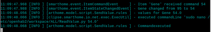

Ok thanks, I did it and here is what the log shows
So it seems erverything is ok but my ReadValue.py is still empty
I tried different command line but nothing is working
