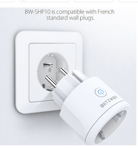

if you want to go cheap and simple…(for dumb TVs)
i use an MQTT outlet with power moniter just to know on or off
if you put somthing like tasmota you can play around with what happens after a power break
this one is nice and small …
and RM3 to IR the TV
so its something like 25$ per TV
things to note…
  1. IR is stupid, if you have another TV in the way… or somthing like LED strip things can go wrong
  2. it will compleacte things a litle bit , you will need some rules
