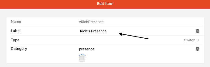

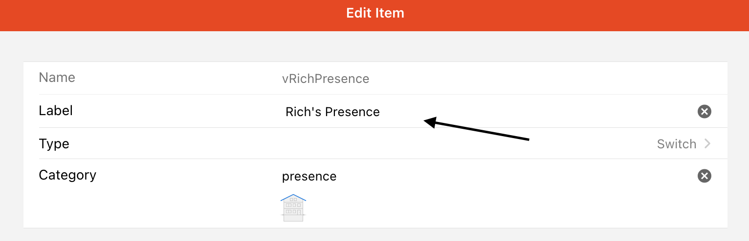

Assuming you are in fact referring to sitemaps and not MainUI then the answer is no. Sitemaps are basic and simple by design.
And it’s not clear what you are asking for. You want a way to define a label for an Item in metadata instead of using the Item’s label field or the sitemap’s label field? I don’t see how that makes anything any easier. It just moves the problem to a different and less obvious place.
If this is what you are really looking for then don’t define the label on the sitemap and define the label on the Item.
But if you want to have a different label for the Item and the Sitemap and you want to change the sitemap’s label without changing the sitemap then you can’t get there from here.
