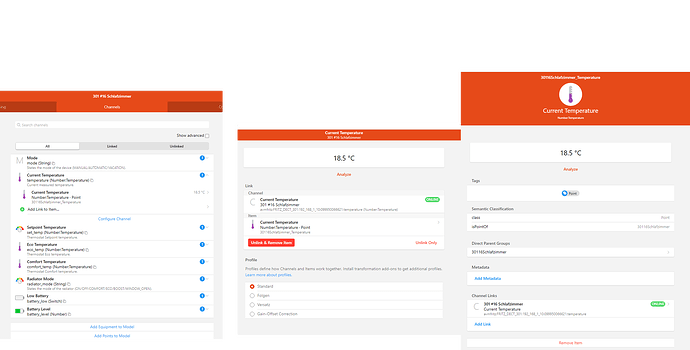

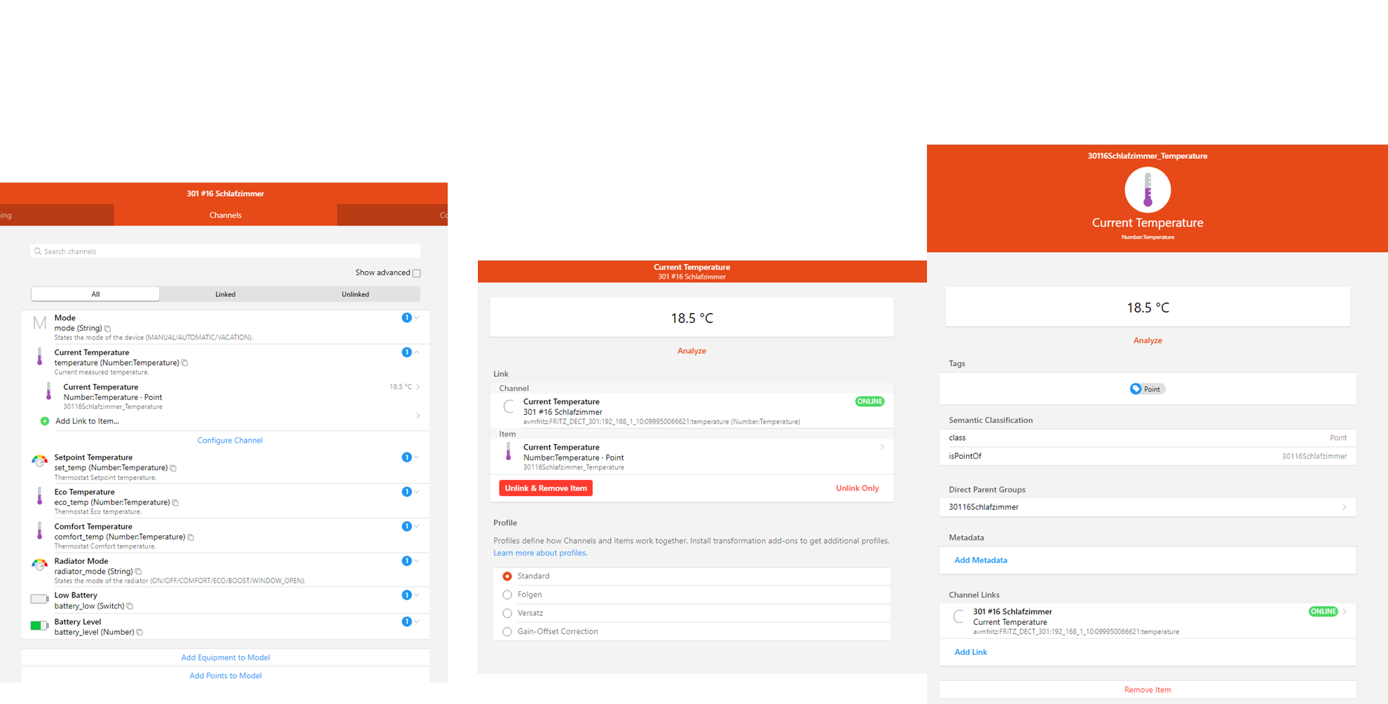

Sorry, I was not very specific:
This is the thing
UID: avmfritz:FRITZ_DECT_301:192_168_1_10:099950058880
label: “301 #1 GästeKlo”
thingTypeUID: avmfritz:FRITZ_DECT_301
configuration:
ain: “099950058880”
bridgeUID: avmfritz:fritzbox:192_168_1_10
With these channels
Where I linked one to an item
It only appears in the chart when deselecting the default DB

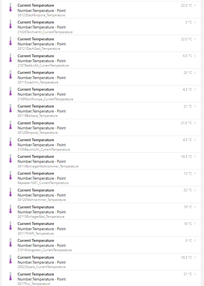

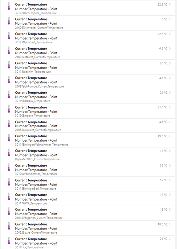

None of the persistence services are remotely interested in your Things or channels. They operate on Items - it looks like the Item of interest is named
3011GasteKlo_CurrentTemperature
and it’s of type Number:Temperature
The type should be fine.
I note that there is an underscore in the name, which should be okay BUT has been associated with influxdb problems in some OH versions - what’s yours?
Of more concern though, your Item name starts with a number.
Names must not begin with numbers. Spaces and special characters are not permitted.
I know parts of openHAB deal with it, but parts don’t.

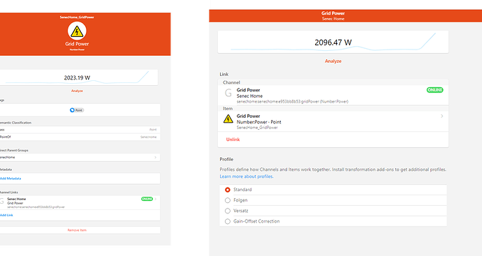

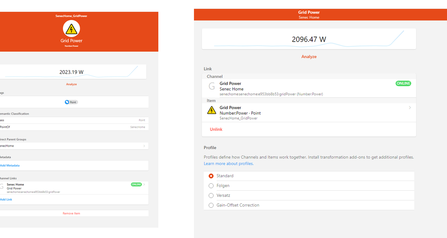

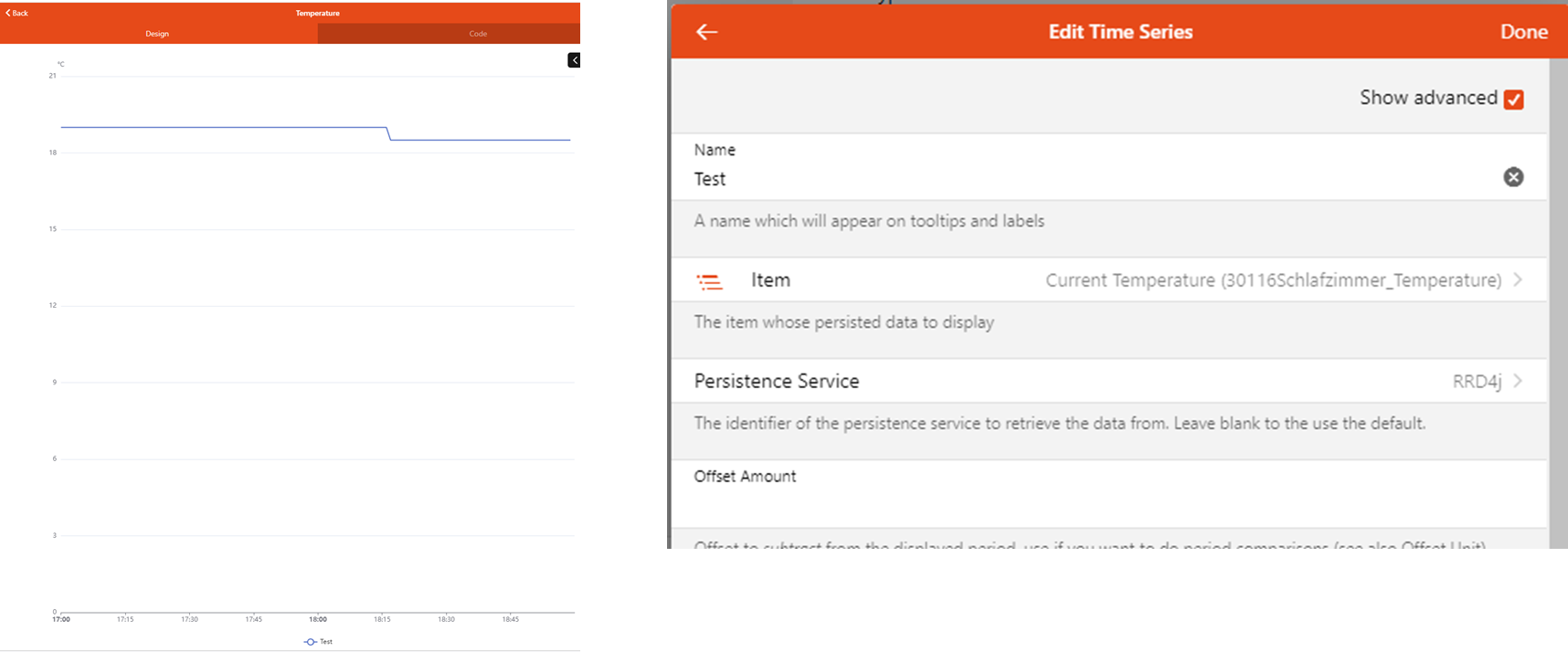

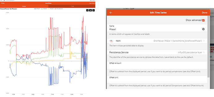

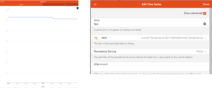

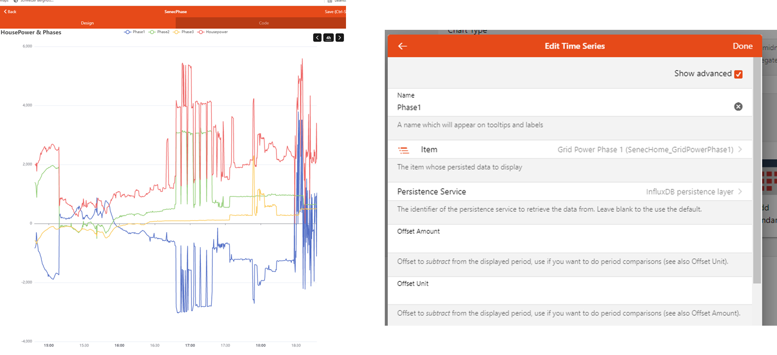

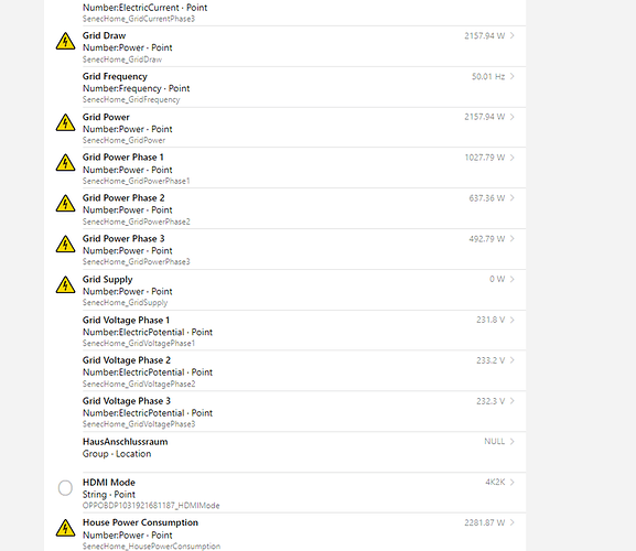

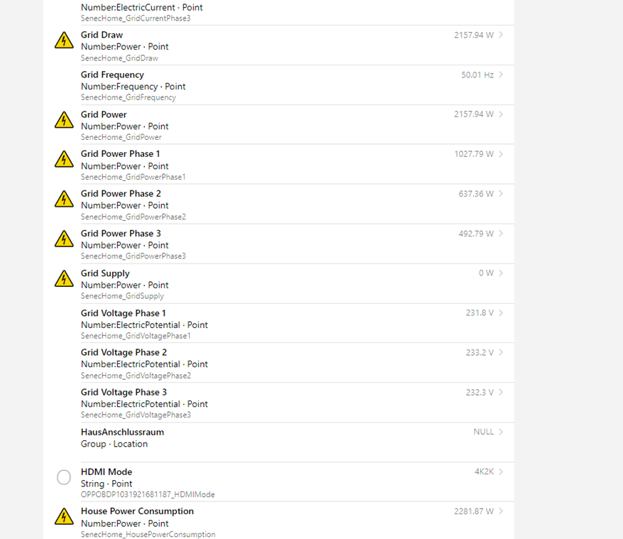

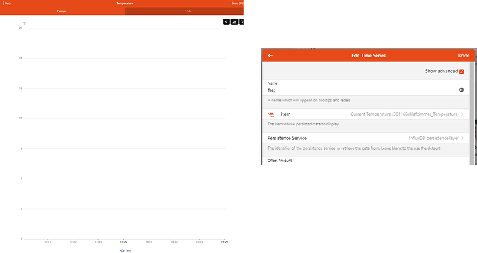

I show a couple of screenshot to illustrate the issue:
The good one:
Senec Power channels
nice chart out of influxdb

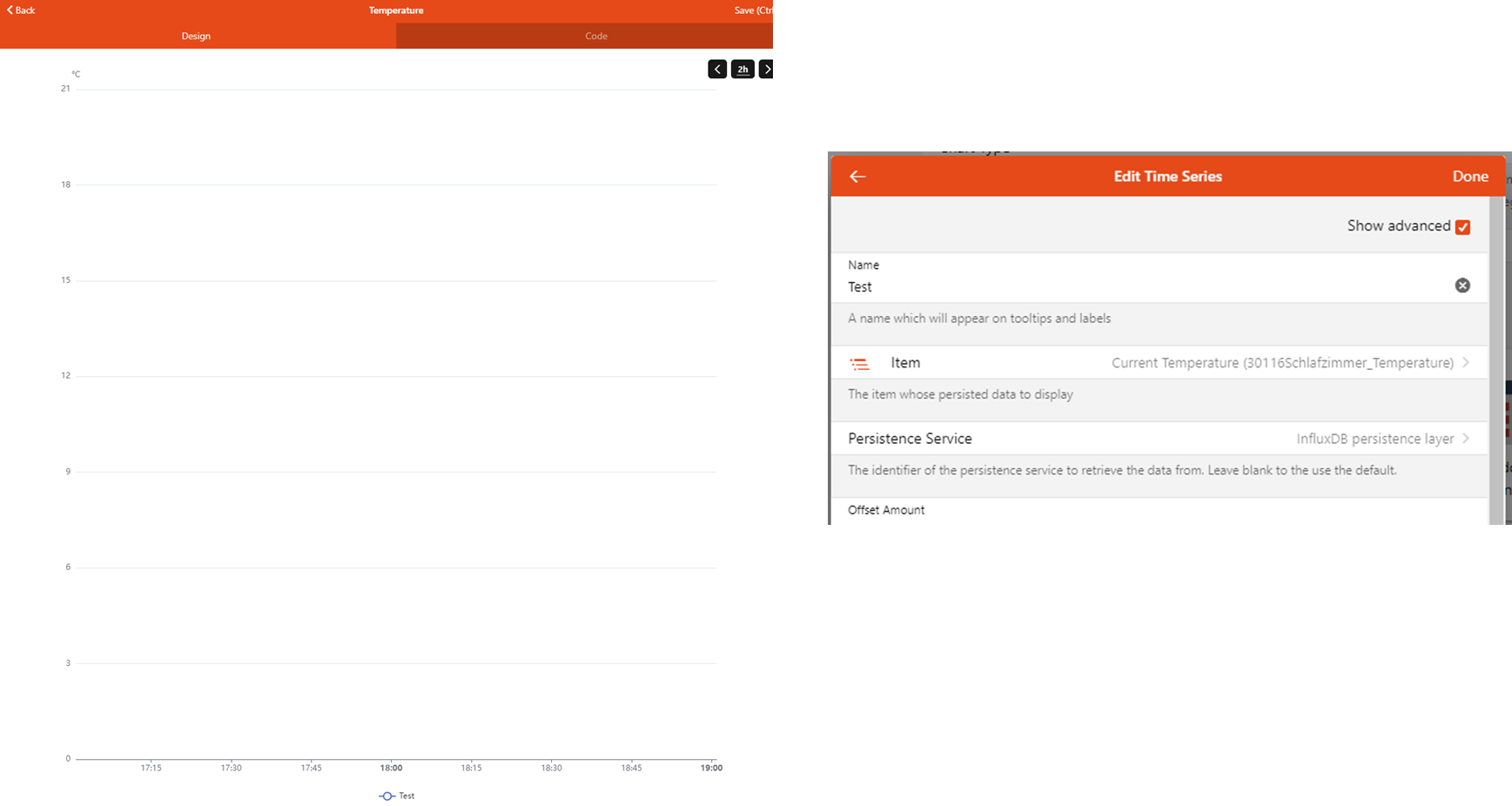

The bad one. Fritz Thermostate Temperature
Data goes into RRDJ4 (Influxdb set as Default)
no data in Influxdb
So the bad ones, and only the bad ones, all start with a number in the name?
How long did you wait, and what are you using to confirm data in the influx database?
Please note that the Default persistence does nothing except for set the default historical data source for charts and rules. So RRD4J is not interfering with anything, it’s not stealing any data - its existence is irrelevant, as the others have said. It did not ‘switch’ to RRD4J - it was going there already
