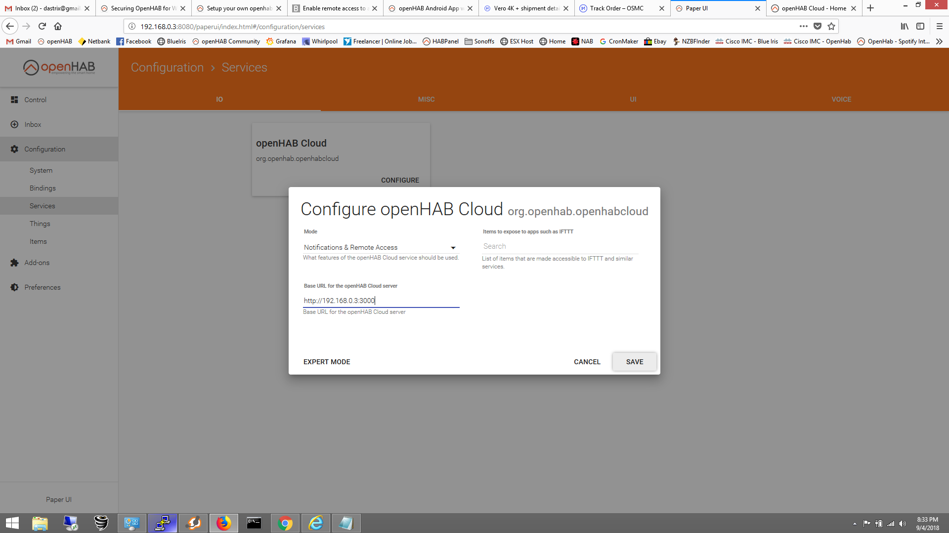

Can anyone confirm what needs to go into here?
Hi @dastrix80,
If the cloud instance is running on the same computer or network as the openhab instance, you can address it by the local address as in the image you sent.
If the cloud instance is on Internet, you need to point to the public address (i.e. https://myhomedomain/)
Answering your previous question: yes, you need to secure your cloud server behind a proxy. I use a highly customized Apache, so I cannot help you on nginx, but there are some how-to’s and tutorials already around.
