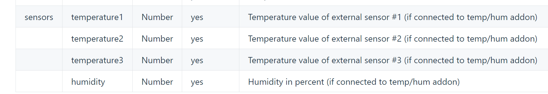

for channel names see binding documentation
channel name is probably:
shelly:shelly1:xxx:sensors#temperature1
depeding on where you connected the sensor

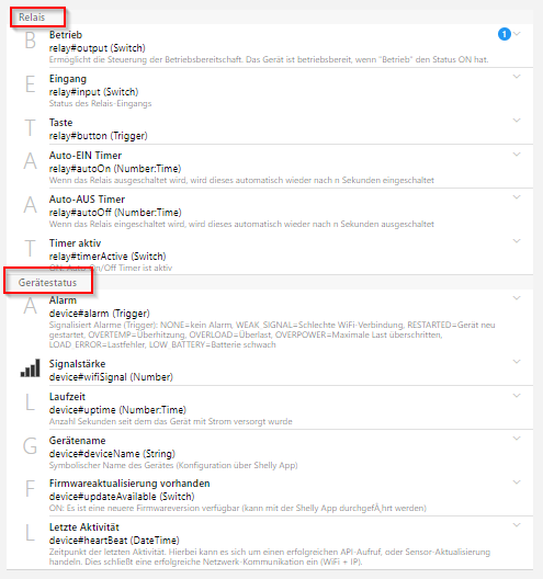

Although the addon is installed, the sensor channels are not shown in OH3.
Below picture of my shown channels.
what version of OH3 are you on? did you delete and re-discover your thing?
is the addon visible on the device‘s website?
