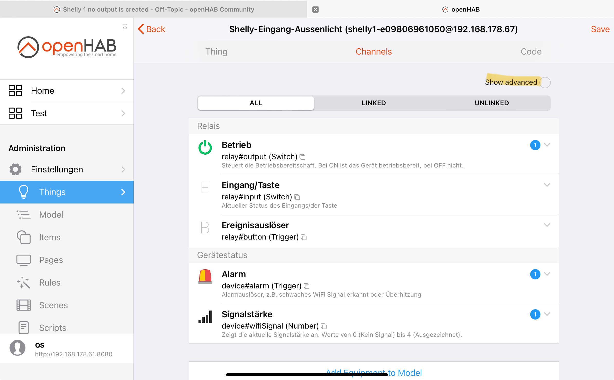

Hi Gottfried,
welcome to openhab and welcome to the community.
When you open the Thing‘s channel tab, press „Show advanced“ in the upper right corner.

ok. And you are sure that there is no such check box in the upper right corner as can be seen here:
If not, please delete the thing and readd the thing based on the steps above including the optional first step
