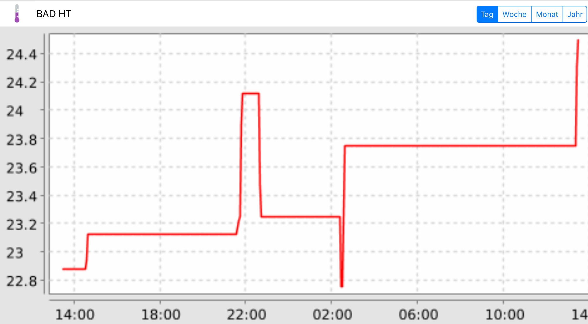

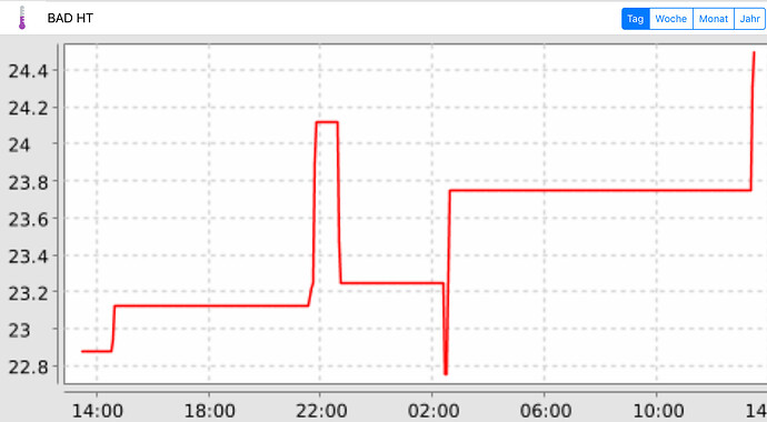

even if the temperature or humidity changes significantly?
Depends on your treshold settings.
Just try to open the device webserver when you see the error os occuring in the log.
I know - increase/decrease was above the thresholds
Did you set treshold below 1 degree? If not, don‘t see anything wrong.
I saw that there is a firmware 1.52, maybe they fixed something (1.51 was already a fix for the event handling)
