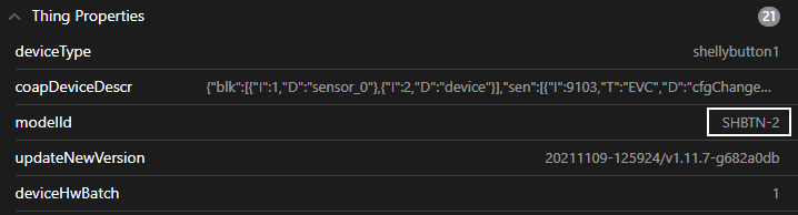

I noticed another thing, it reports SHBTN-2 instead of SHBTN-1
coapDeviceDescr:
{"blk":[{"I":1,"D":"sensor_0"},{"I":2,"D":"device"}],"sen":[{"I":9103,"T":"EVC","D":"cfgChanged","R":"U16","L":2},{"I":2102,"T":"EV","D":"inputEvent","R":["S/L/SS/SSS",""],"L":1},{"I":2103,"T":"EVC","D":"inputEventCnt","R":"U16","L":1},{"I":3115,"T":"S","D":"sensorError","R":"0/1","L":1},{"I":3112,"T":"S","D":"charger","R":["0/1","-1"],"L":2},{"I":3111,"T":"B","D":"battery","R":["0/100","-1"],"L":2},{"I":9102,"T":"EV","D":"wakeupEvent","R":["battery/button/periodic/poweron/sensor/ext_power","unknown"],"L":2}]}
