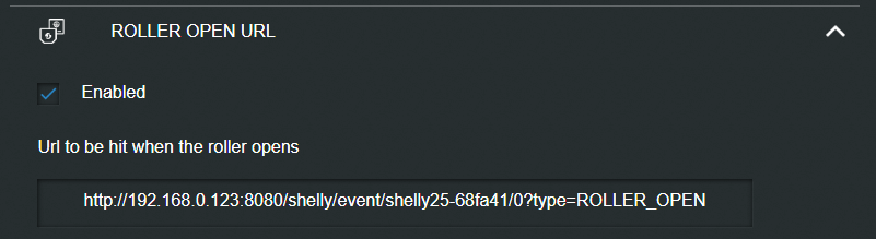

i try to use a shelly 2.5 for roller shutter and will read the trigger events … but i don’t see the events in openhab.
rule "Shelly Event"
    Channel "shelly:shelly25-roller:68fa41:roller#event" triggered
        logInfo("Shelly", "an event was detected")
//Do the tilting stuff
am i making a mistake? in my opinion it should fit like this
the control of the rollershutter works fine
Did you setup the URL manually? I would expect roller_open instead of ROLLER_OPEN
Enable DEBUG log, this shows incoming events

thanks, that with roller_open solved my problem. now i receive the triggers
