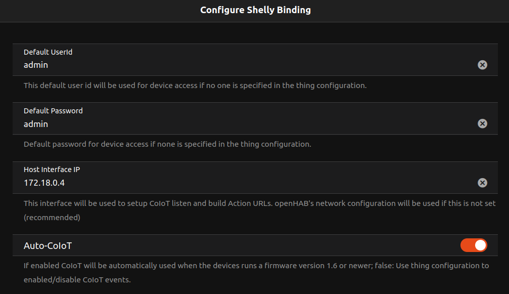

From here there are things I’d like to be improved:
  1. Password in Binding config is showing in plain text
  2. Authentication working with meter channels
  3. kWh energy consumption channels working (if possible, on the device?)
Cheers Markus - good up the good work! :metal:
I think it’s not related to auth in general, but maybe some timing etc., need to look into that.
Channels should be updated, all = 1-4
I made a change to have *** instead of the cleartext pw (as in the thing config)

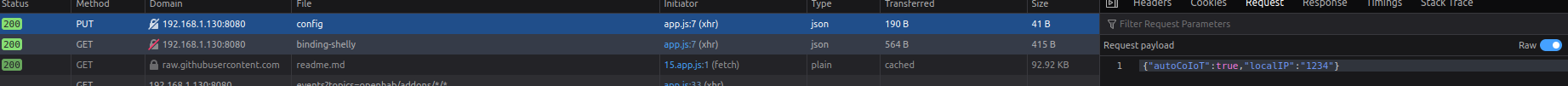

Playing with shelly/config, I changed the IP ā€œHost Interface IPā€. Whenever I reboot the host, my openhab has different IP thus I have to change as well the Shelly config over and over. When I try to remove the IP(trying to fallback to default) clearing the field , the IP is still there. Any idea how to clear the IP from config?
I tried to resend the ā€œPUTā€ with IP=ā€œā€ without success. Simply if the field is empty, javascript does not add the field to ā€œPUTā€ at all.
delete and re-discover the thing
Thank u Markus for hint, but is about ā€œConfigure Shelly Bindingā€ and even that I changed the binding to latest one, the IP is still there. I also tried to clear cache without success and do not know how to modify it by cli. I guess the java script allows to enter anything but field can not be empty.

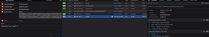

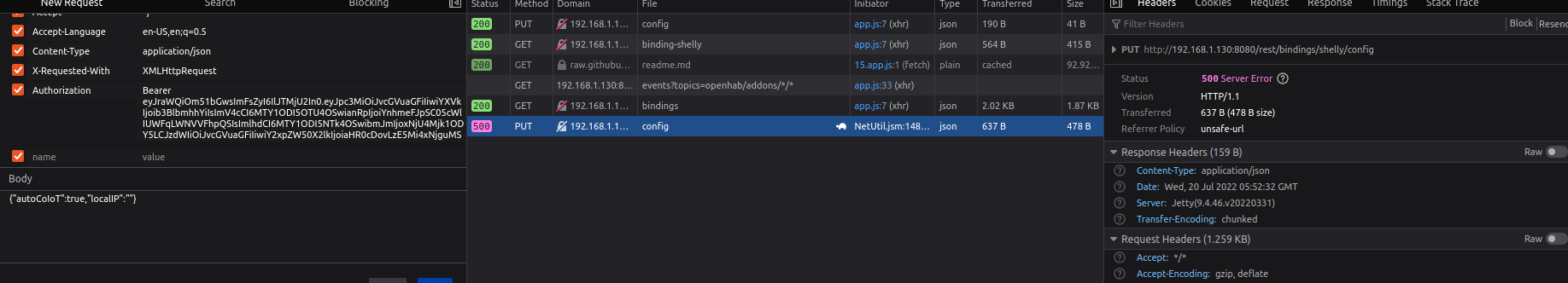

To reproduce it:
open ā€œConfigure Shelly Bindingā€
  1. put something like 1234 into ā€œHost Interface IPā€
  2. save
  3. open Configure Binding again - expecting to see ā€œHost Interface IPā€=1234
  4. clear ā€œHost Interface IPā€
  5. save
  6. open Configure Binding again and u’ll see ā€œHost Interface IPā€=1234
Thanks Markus - did solve the problem
this UI element is not provided by the binding. The binding exposes field definitions, which are processed by Main UI, which handles the input. The framework then handles serialization, so nothing I could do.
