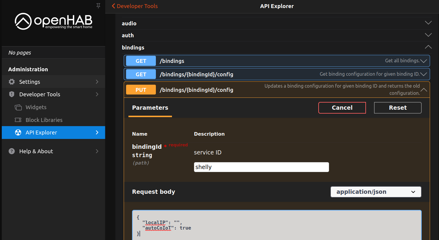

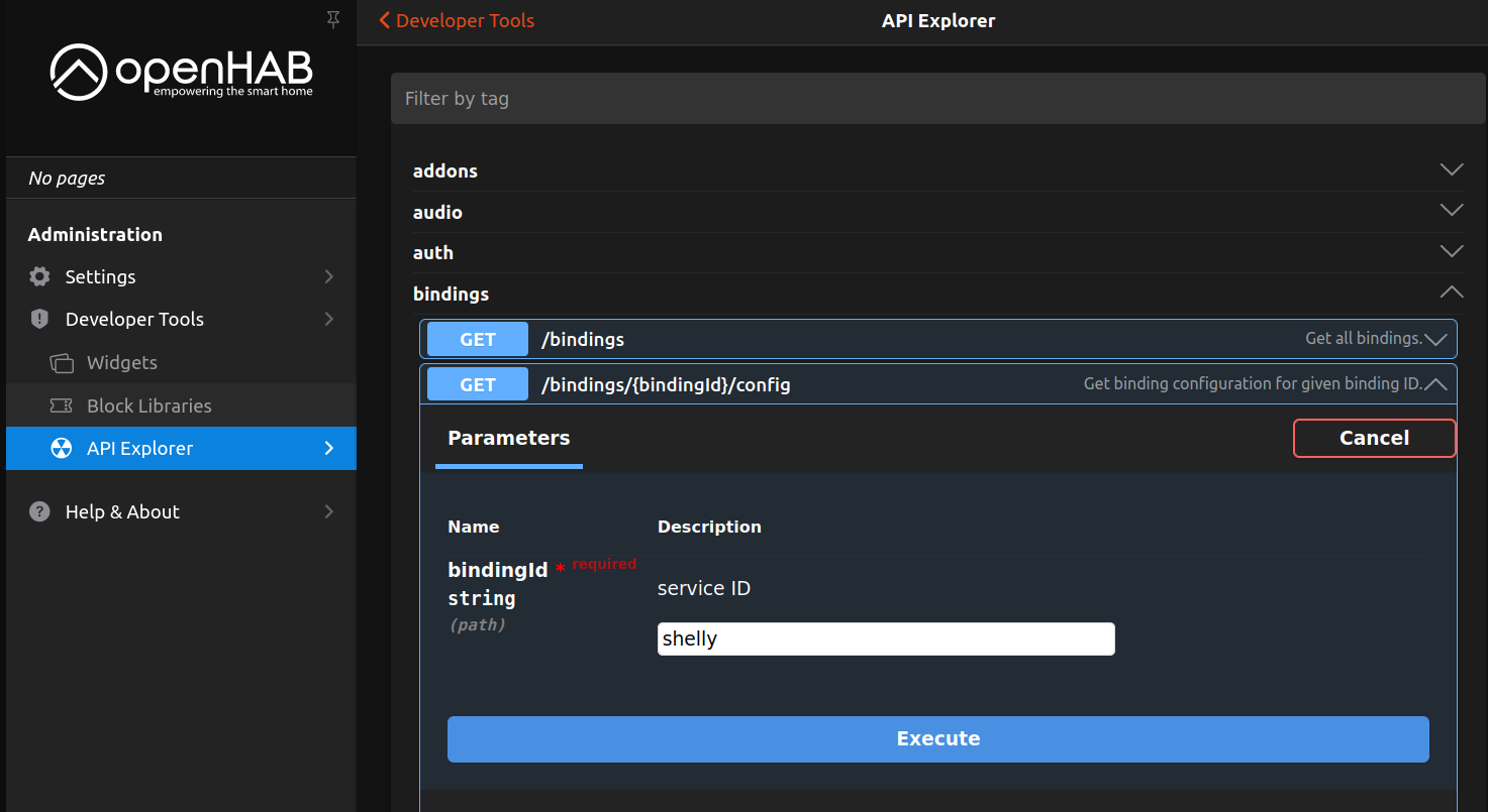

Thank u Markus.
Marcus finally I found a neutralization.
Steps:
  1. Open Openhab 3.3 GUI like http://192.168.1.130:8080/developer/api-explorer
  2. execute GET (for shelly binding)
  3. copy result and edit PUT method
  4. execute PUT
  5. IP is NULL
:+1:
