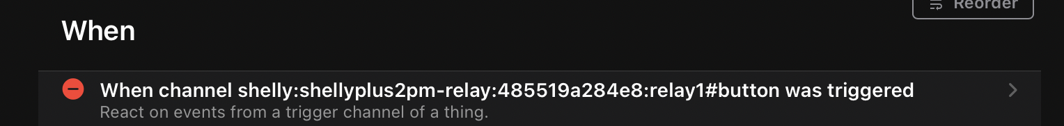

Thank you very much for your effort @markus7017 .
Successfully installed the 3.4.0 Beta to get my two 2PMs (connected to the shelly 2x wall switch) into openhab.
Not sure if Iām doing something wrong or itās simply not (yet) supported. Unfortunately I was not able to find any info on if this is the case.
Iām trying to set up (multi) button-presses within latest version of Openhab 3 and the beta of the binding to activate some rules.
rule "test button press"
Channel "shelly:shellyplus2pm-relay:485519a284e8:relay1#button" triggered
logInfo ("schalter.rules", "shelly button pressed")
But nothing is happening/showing up in the logs when Iām pressing the left button of the wall switch.
When I configure the channel via UI, it keeps being āidleā and also no other rule is executed - only when I manually ārunā the rule. But not when triggered by the physical button.
Sidenote:
Any idea of what Iām missing or is it the (currently) expected outcome?
Edit:
I changed eventsCoIoT to āfalseā (was true) and now I see some data in debugging. Seems (!) to have made a differenceā¦
But something really weird whenever I press a button now:
āThing āshelly:shellyplus2pm-relay:485519a284e8ā changed from UNKNOWN (CONFIGURATION_PENDING): The device was restarted and is again being initializedā to Online
