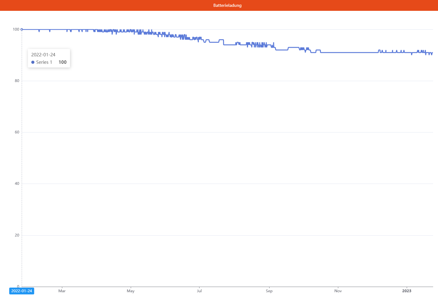

I don’t want to interrupt the discussion but can anyone suggest a configuration for a dw2 sensor that does not drain the battery like crazy? I installed three of them not long ago and thought they broke after two months or so because they did not react anymore but the latest battery level was still at about 60% (which was really bad already). However it turned out that the battery was just too low to wake the device…
Does it make sense to invest in another set of batteries or should I just dump them completely :sweat_smile:
Mine have longer life. I have 8 pieces DW2. This one as an example is after 1 year at 91%.
Settings (bold marked are important):
  • Tilt: enabled
  • Vibration: enabled
  • Wake Up By Lighting: disabled
  • Temperature Treshold: 1.5
  • no I/O + Sensor Actions
  • static IP address
  • current firmware v1.12.1
  • Batteries: CR123A Kraftmax Pro, 20 pieces for about 30 Euro.
I’ll give it another try. Mine looked more like this. It died at 67%
