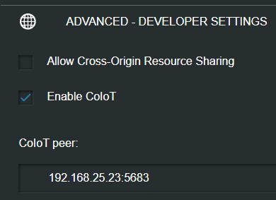

For me its not a battery powered device. Its a regular good old Shelly1 and I have the feeling its network or process related on in the docker container.
My Shelly1 is configured to ColoT with IP:Port like this:
.23 is the IP of my OH3 server. its the dedicated IP of the OH3 container within the docker VLAN.
So now checking the service on OH server port 5683 from within the container. One has to apt install net-tools before:
root@openhab:/openhab# netstat -tulpn| grep 56
udp        0      0 0.0.0.0:5683            0.0.0.0:*                           -
root@openhab:/openhab# netstat -tulpn| grep 8443
tcp        0      0 0.0.0.0:8443            0.0.0.0:*               LISTEN      -
While Openhab port is listening, the ColoT port isnt.
Also I cannot telnet tcp:5683 from the same local LAN, but can OH3 web port.
So in the end, I think the ColoT messages cannot be delivered to Openhab since the TCP endpoint is not available from shelly1 device point of view.
Any ideas welcome
As you can see from the netstat output, the CoIoT port is a UDP port. That said, I think this is the intended behaviour/output of netstat:
UDP is connectionless. Unlike with TCP, it has no concept of “listening”, “established”, “closed”, or anything like that. If a UDP port is open, it appears in the listing; if it’s not open, it doesn’t. There is no other state to display. Showing LISTENING or something similar in that column could imply that there are other possible states, and that would be false.
Source: https://superuser.com/a/1096777
I think this is also the intended behaviour as telnet only works with TCP, as far as I know. Connecting to an UDP port and pretending it is a TCP port won’t work, as OH will not answer with the required packages to perform the TCP handshake. You could use nc to connect to the UDP port and send some bytes to it.
Edit: Sorry for just saying “everything you observed is the normal behaviour” - this obviously doesn’t help you with your problem. Maybe you could try to sniff the raw network data using Wireshark to find out, if the packages get delivered to the OH CoIoT port. If you find out, that the packages get delivered, maybe it’s the same problem as I have …?
UDP is a connectionless protocol, this ist the reason why you don’t see LISTEN state.
BTW: use “ss” command instead of netstat from net-tools. netstat is deprecated.
“ss” shows for UDP UCONN or ESTAB.
See my (working CoIoT) setup output:
# ss -unlp | grep 5683
UNCONN 0      0                                     *:5683             *:*    users:(("java",pid=1508,fd=234))
You can also trace the network traffic with tcpdump on OH host if there are incoming Coap packets:
tcpdump host <Shelly Device IP> and port 5683 -n -vv -X
Thanks for your explanations @igi and @atetzner .
tcpdump confirms receipt of UDP packages from the Shelly1 appx. every 15 seconds. When ringing the bell connected to my Shelly1 I even see more UDP packets flowing. So its not network or service.
Thanks for your help on this.

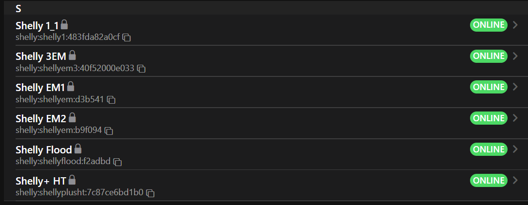

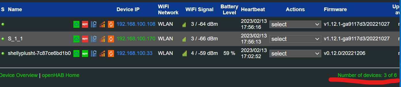

How does the Shelly manager decide whether to show devices or not?
I have 6 Shellys that were set up via text files and also work. When the manager is opened it says there are 6 devices but only shows 3.
Openhab 3.4.1 is currently running, but the error has been there for a long time, I think since 3.2.
is device filter activated?
The device filter is set to all. I have 2 Shelly EM with the same configuration. One is displayed (is the first entry without a name) and the other is not. :thinking:
Do the missing devices also have an empty name? Maybe try to provide unique names.
The Shellys all have a name, see the things file
Thing shelly:shelly1:483fda82a0cf        "Shelly 1_1" @ "Hof"       [deviceIp="192.168.xxx.170", userId="", password=""]
Thing shelly:shellyem:d3b541             "Shelly EM1" @ "Keller"    [deviceIp="192.168.xxx.31" , userId="", password=""]
Thing shelly:shellyem:b9f094             "Shelly EM2" @ "Keller"    [deviceIp="192.168.xxx.108", userId="", password=""]
Thing shelly:shellyem3:40f52000e033      "Shelly 3EM" @ "Keller"    [deviceIp="192.168.xxx.32",  userId="", password=""]
Thing shelly:shellyflood:f2adbd        "Shelly Flood" @ "Garderobe" [deviceIp="192.168.xxx.109", userId="", password=""]
Thing shelly:shellyplusht:7c87ce6bd1b0   "Shelly+ HT" @ "Bad"       [deviceIp="192.168.xxx.33",  userId="", password=""]
