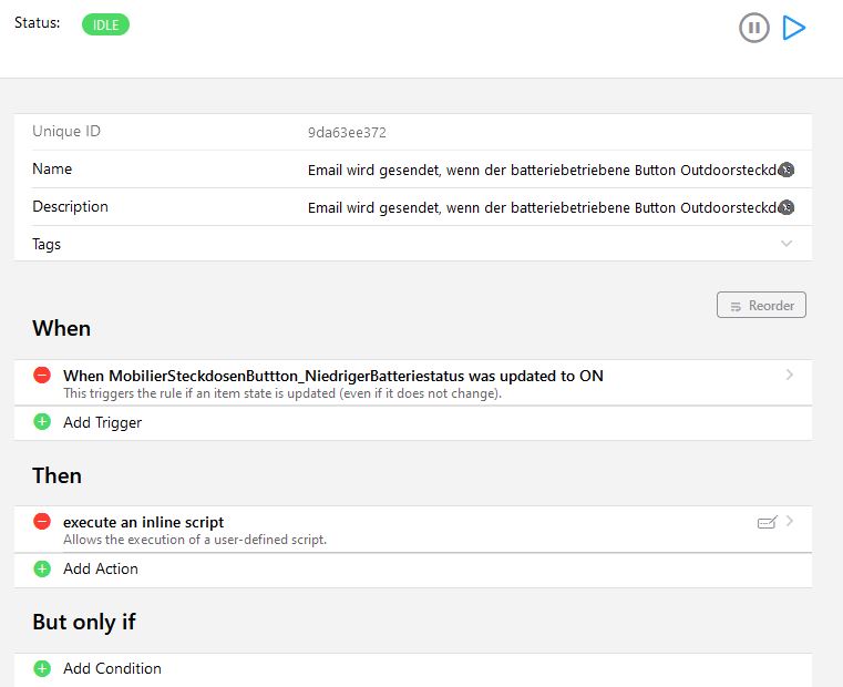

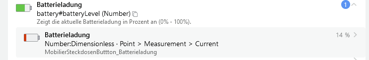

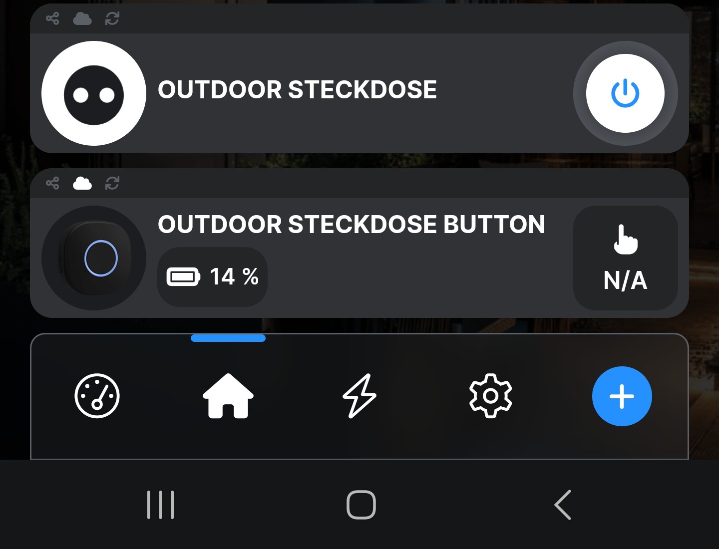

Hey all.
I’m using an 4.1.2 Openhabian installation and the latest DEV binding 4.2
I just noticed, that that the flag for low battery in a Button1 is not more recordnized from OH and therefor an planed rule with an mail to notify me, that there is a low batttery in the button1 is not more running.
So I have no clue, why this flag is not more set to ON. In the Shelly App itself the button1 shows me 14%, and also the last shown is right and actuell in the OH installation.
In OH the last seen is also working, but the flag low battery is not changed fron OFF to ON.
All settings are right set and no changed since 2-3 years.
I remwmber right that 6-8 weeks before it were running successfully, and also an manual trigger of the rule works as expected. Any Idea @markus7017 ?
So for me it looks, that the LowBattery is NOT MORE switch from OFF to ON in the binding.
