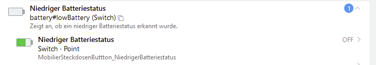

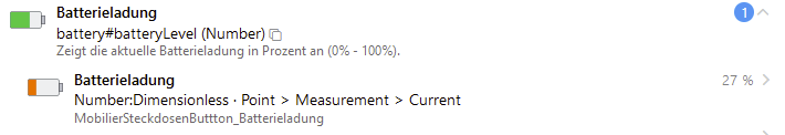

I think you linked the wrong channel
batteryLevel is of type system.battery-level, which is a Number (dimensionless)
lowBattery is of type system.low-battery, which is a Switch
to get the low battery indicator you need to link the lowBattery channels to a switch item
this matches the definition in the binding. Is you linkage correct? Please check openhab.log and events.log

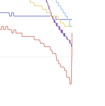

The setup has been working for more the three years now without any changes in the setup of the rules or something else. Every new OH version was going to be used, and also the binding is up-to-date, with the DEV version. I have seven button1 in use (SW version 1.14.0) which all have the same setup. They report once a day, e.g. their battery value. e.g. last 6 month, ever day:
BTW: The purple line is an TRV Thermostat ![]()

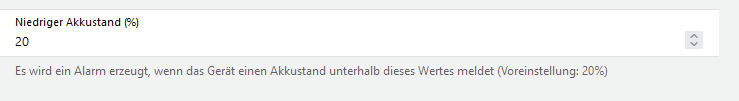

The value itself is in the shelly active, that the LOW BATTERY is reach, because the shelly app itself showed me that yesterday. Last night I charged the button1 for 5 min, so current it is above the 20%, with 27%. red line in the grafikâŠ
But we are talking about the switch for low battery: It was going to be ON, when the battery was less than 20%. Since when ever, the low battery was NOT MORE GOING TO BE âONâ, when the battery was less the 20%, e.g. yesterday!.
So it is NOT about the selected value (switch), it is about that, the switch is not more going to be âONâ, when the Battery level is lower that 20%. So Markus, please check your binding, what has been changed here in detecting if the button1 send the battery low switch as âOFFâ, or âONâ.
