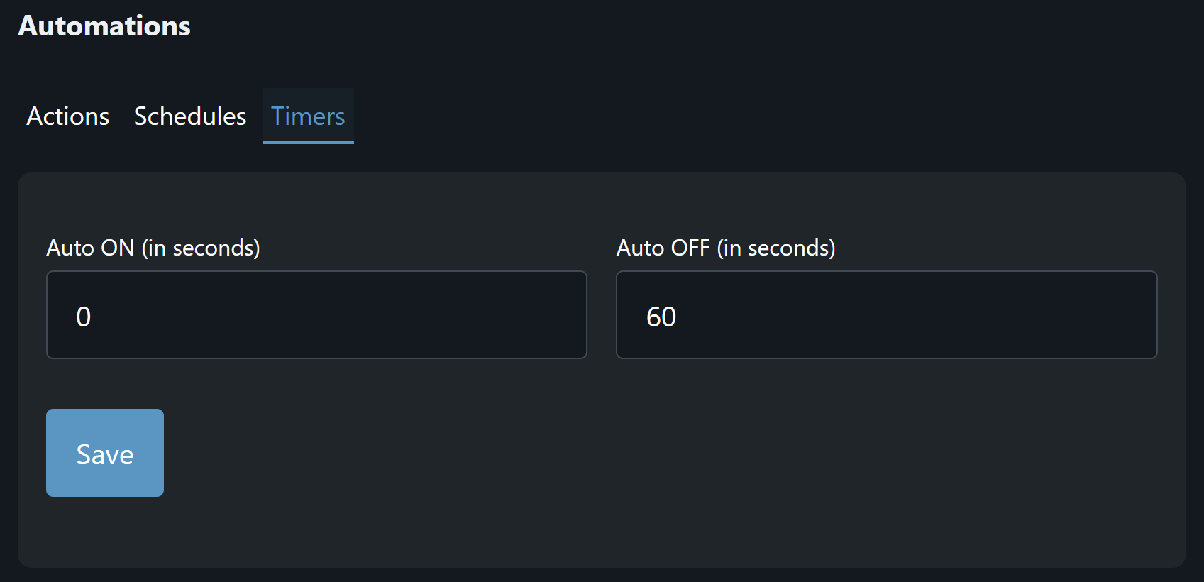

I have just received my new Shelly PlugS Plus as I like to use the AutoOff Timer to set a switch-off time for the plug. I defined the thing correctly and the appropriate items in my items file:
Number Shelly_1aoff "Shelly PlugS Plus 1 AutoOff Timer [%.0f]" (gShelly)  {channel="shelly:shellyplusplug:##########:relay#autoOff"}
Switch Shelly_1tactive "Shelly PlugS Plus 1 Switch" (gShelly)  {channel="shelly:shellyplusplug:##########:relay#timerActive"}
There are two issues that I like to raise:
  1. With Firmware 1.3.2 there is no more switch for AutoOff (see screenshot below)
  1. When I change the timer value in the Shelly WebUI the change is recognized in openHAB and the item shows the altered value. If I change the value in openHAB (tested with the API Explorer) then the value does not get changed on the plug (checked in WebUI):thinking:
    The documentation shows that the autoOff parameter is read/write and hence I expect that the plug should receive and apply a value sent from openHAB
What am I doing wrong?
Thanks for any hint and support :slight_smile:

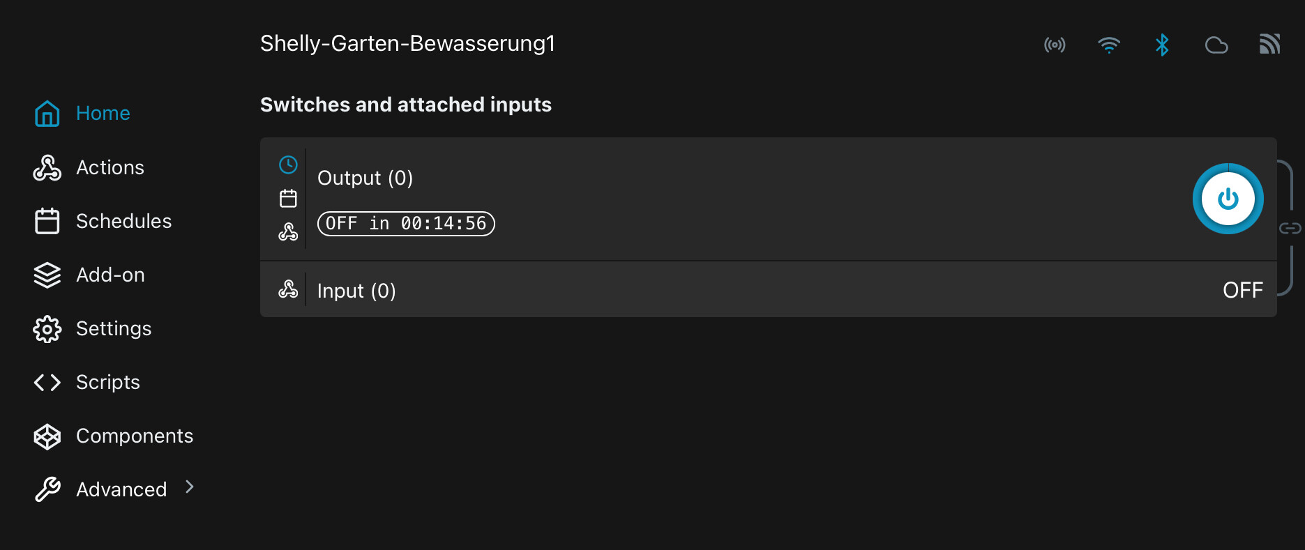

Hi Markus,
is it possible for you to make the timer countdown (see picture) available through a channel?
This way the countdown can be made visible in a widget and a subsequent action could be triggered once the timer ends.
EDIT
However, on a second look, I guess it is a bit more than simply feeding a channel as the timer value seems to be calculated in the GUI and is not available as an endpoint.
See http://192.168.178.146/rpc/Shelly.GetStatus
