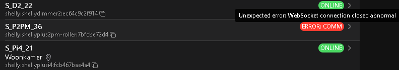

**Shelly Plus 2PM works fine (but i use Openhab! **
Openhab 4.2.0 the binding is not OK for the optie Cover used by Rollers
  • I had over the years a raspberry PI4 with OpenHAB 3xx til 4.2.0 working fine for many years with plugwise plugs.
  • Last year i did go to an PI5 with OpenHAB 4.2.0
  • After install everything works fine again
  • Then i started with Shelly module’s. Many Plus i4, Dimmer2, Plus 2PM installed in my home.
  • Most of the 2PM are for Rollers ( setup 2PM as Cover)
Final status for 1 month ago was that everything was working fine.
Then i saw that my 2PM did have FW 1.0.7 and I started with update for all Shelly’s to the last stable version 1.4.2.
The most Shelly module’s had no problem with it.
Only the Shelly Plus 2PM, the ones in the OH binding where not seen any more and the ones already working in OH :
But the one i did not update is still working fine
Then i started reading , asking but no result !
Then i started new with one Shelly Plus 2PM with FW 1.4.2
factory reset. as i was started for years ago.
  • factory reset start IP 192.168.33.1
  • By mobile I go to Wifi and set my static IP (192.168.0.36), Sub, GW and DNS SAVE !
  • I dit go to the webpage off the 2PM on 192.168.0.36 and seem OK.
  • Settings : only Wifi !
So after factory reset the 2PM is seen in the web and in the OH binding !
  • The 2PM is standard setting on Switch.
  • all the testings for the 2PM as Switch, seen in the openhab binding , seen in Openhab by things scrips and scheduls are working everything looks fine for me.
BUT THEN : i have to change from Switch to Cover for my Rollers.
I did the changing 2 times again from factory reset because i can change directly in the webpage from the 2PM or later on when it is imported in OH.
1 - Factory reset and the standard settings !
  • 2PM OK in the web
  • Before i changed to Cover, the 2PM is seen in OH binding
  • then i switched the 2PM to Cover and directly the 2PM is disappeared in de OH binding.
    after new scan it stil is disappeared
2 - Factory reset and the standard settings !
The same happen 's if you do not Factory setting but you go back chancing from Cover to switch.
  • 2PM OK in the web
  • Seen in OH , import in OH everything goes fine
    But stil it is an switch ! Relay mode
I can not change it to Cover in OH
If i change it in the web than noting happen’s in OH it still is a Switch for OH
The one with FW 1.0.7 is still working that what i need,

Same problem here, since I updated a ShellyPlus2PM today to Firmware 1.4.2 when used as cover. I have several ohter ShellyPlus2PM in use as Switch with Firmware 1.4.2, they work as expected. As far as I know a firmware downgrad is not possible, so I have to change the ShellyPlus2PM to an old Shelly 2.5

I didnā€˜t reply earlier because I thought that all users who had problems with 1.4.2 managed to get it workng anyway. I also have 3 shellyplus 2 and they are working fine in roller shutter mode.
In the end, you get it working either in the way Andreas described or you need to remove the thing, clean cache (channel links will be deleted, too, and you have to re-link the items), reboot pi, restart shelly.
After openhab is up and running wait a few minutes and watch the inbox. Typically the binding detects new devices pretty fast.

Start ssh session and execute the following commands:
sudo systemctl stop openhab
sudo openhab-cli clean-cache
sudo systemctl start openhab
but follow the order described as above.
I guess you have a snapshot binding installed?
In this case you need to wait until openhab is running and then reinstall coap services:
sudo openhab-cli console
password is habopen
then:
feature:install openhab-transport-coap
It is worth a try. There are many who got it working. Also try to run through the whole procedure 2 or 3 times.
