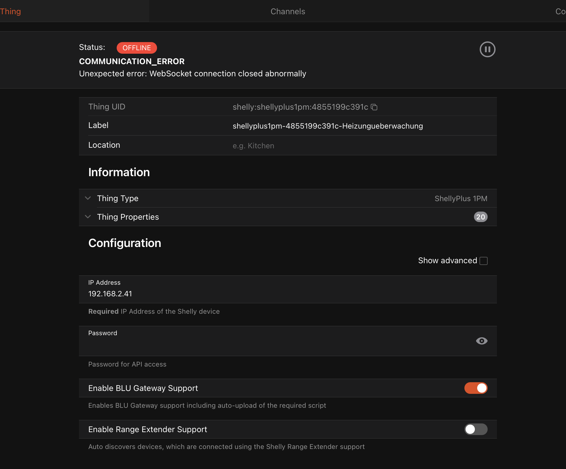

Also a shellyplus1pm is not recognized anymore:
