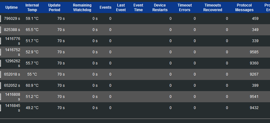

i rewrote the discovery for APIv2 from RPC to “classic” http request. Exactly how it described in https://shelly-api-docs.shelly.cloud/gen2/ComponentsAndServices/Shelly#http-endpoint-shelly. As far i got from debugging, discovery alone via RPC runs smoothly. Thing handler alone runs smoothly. But, if the thing handler is already online, then the discovery will close already open RPC channel for this thing handler. And the thing is forced to reconnect. As far number of channels is limited to 6 (https://shelly-api-docs.shelly.cloud/gen2/General/RPCChannels), this causes a kind of “denial of service” attack on Shelly, which force Gen3 devices to reboot.
BTW: My “hacked” version runs now round about 1.5 weeks without any issues on my local environment:
Surprisingly, Gen2 devices have much more protocol messages, as Gen3 ones.
