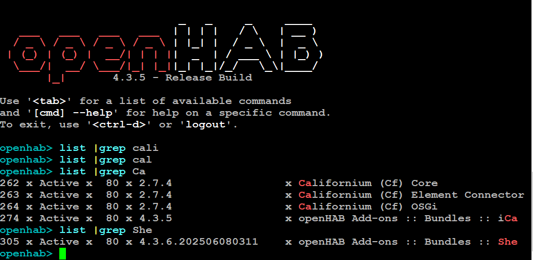

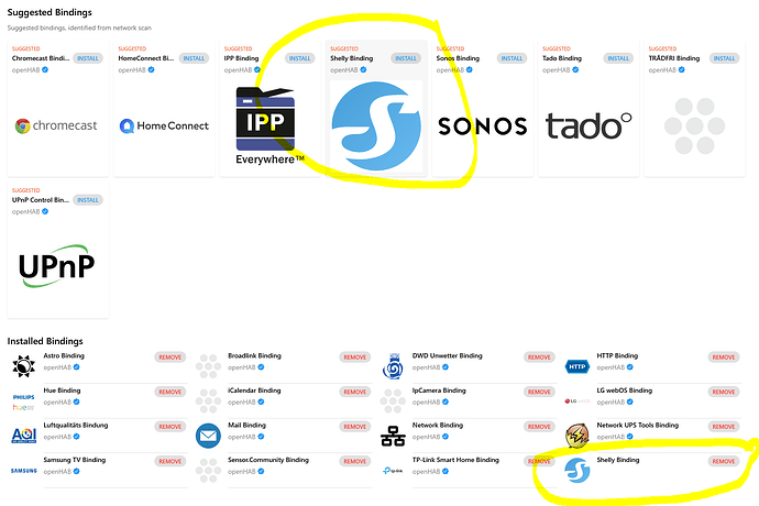

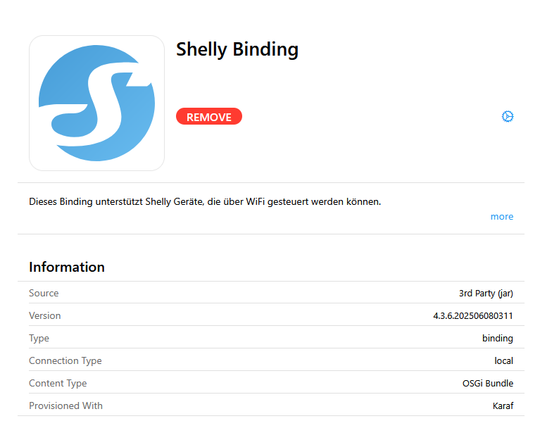

I tried the new 4.3.6 version too:
All channels of my installed things were now shown correctly.
But when I tried to create a new thing the Shelly binding was not shown at all. Did anybody else experience this?
EDIT: Problem solved
Have you checked that is listet?
the upper is the offical, the unoffical is listet down.
Are you sure it is running?
Have you manual added the command in the OH console:
“feature:install openhab-transport-coap” ?
It should work fine now.
Meanwhilie I also flashed my shelly plus 1 with th 1.7.0-beta1 and it has been working over the night.
I tried again and now it works. Probably I swapped versions during copying. Thank you.
