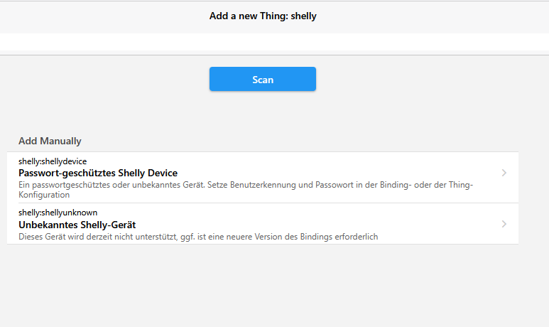

hmm, strange. I need to check the build output, maybe there is a typo in the XML descriptions
I rebuild and updated the 5.0.0 snapshot, could someone please verify that it shows all thing types when adding a thing manually?

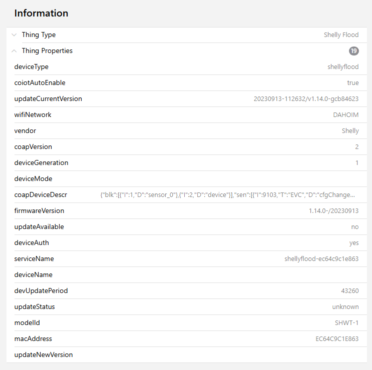

Does anyone have real experience with a Shelly Flood? Mine (see post I replied to) keeps being unresponsive in openHAB. I wonder whether that’s because it only seldom sends out data, and the binding only seems to ‘look’ for data with regular intervals. So the packets miss the window.
Is that possible, @markus7017?
I have on in the laundry. Once it is ONLINE, it is working fine. It sends updates via Coap.
I have 6 Shelly Flood which work flawlessly. But not with the binding. The binding does not work reliably with battery devices and every (OH) restart will become a gamble whether your device will come online or not.

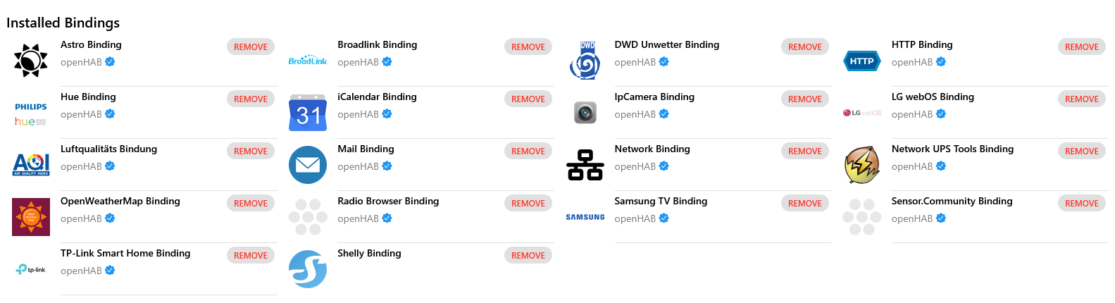

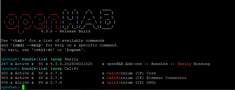

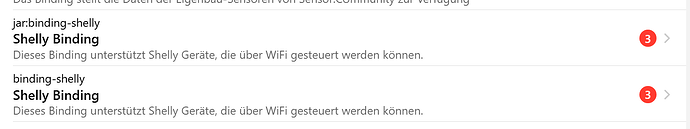

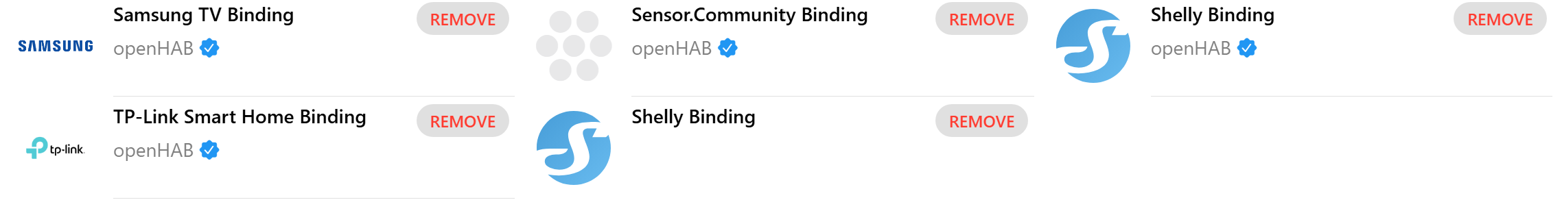

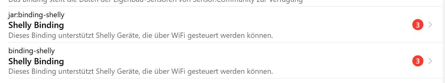

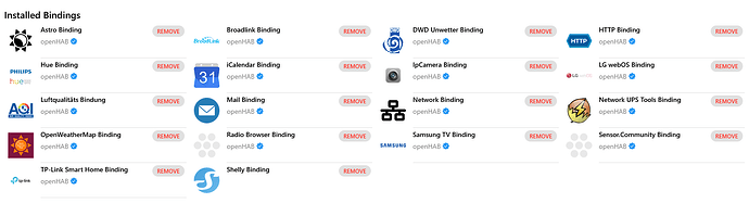

On my PI5 with a 4.3.5 installation, the 5.0.0 binding can be copied in the addon folder, but after reboot it is not listet. Only after the install the offical binding, will show it for me in the list of bindings. Feature install coap, etc, or california in the “OH console” is there.
So that means I need to add the offical binding, then I have two binding where I can choose:

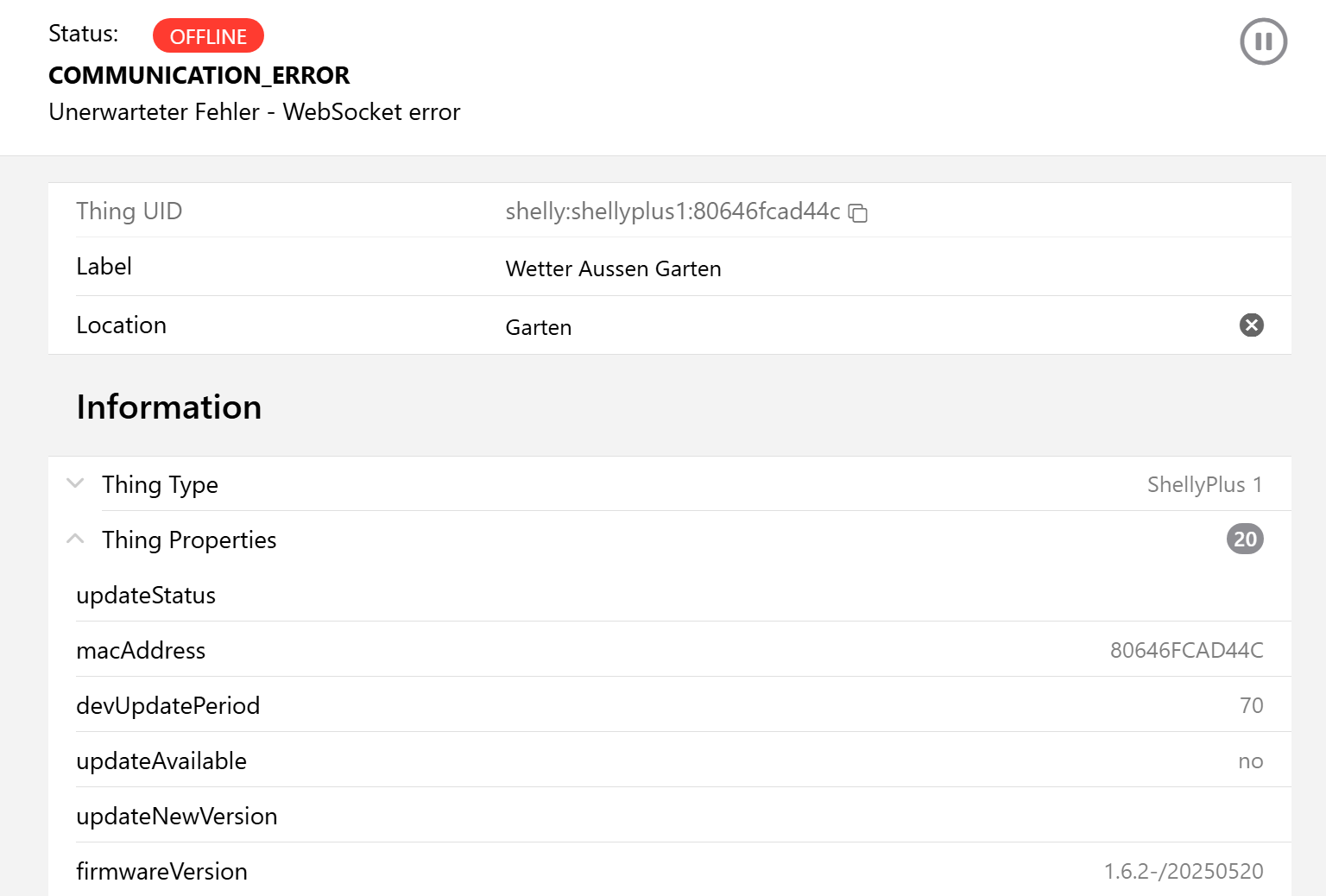

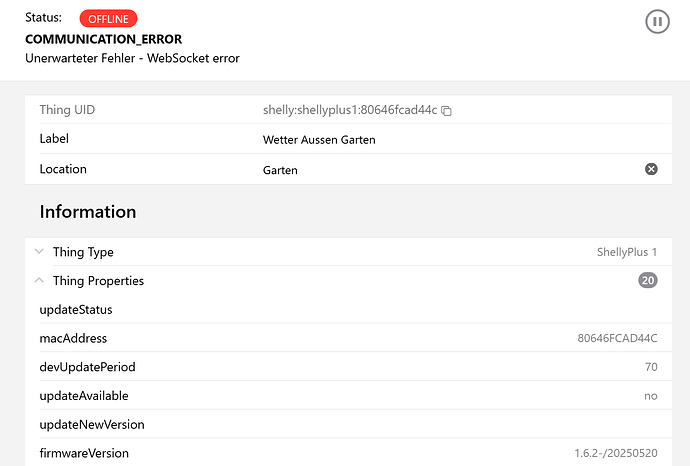

When then adding a new shelly 1 plus, (topline from the two listet), (after I have first deleted the thing), it will be added, but has the same problem, that it went into the problem with “websocket error”
Meanwhile the Shelly has gotten a 1.6.2 FW.

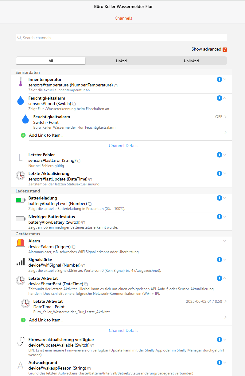

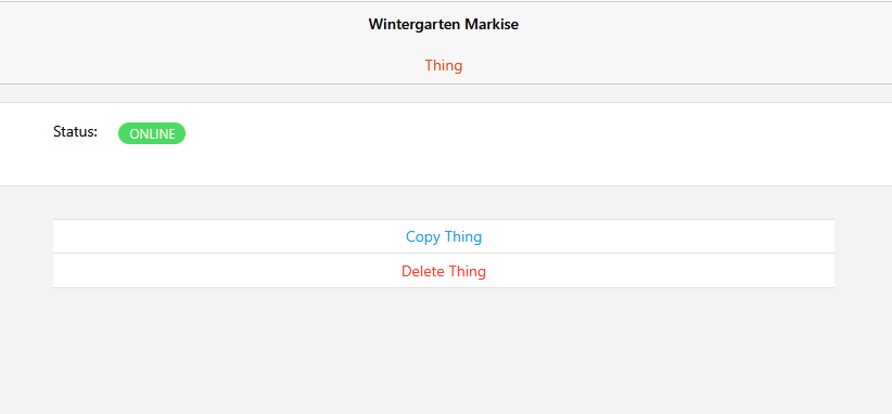

Downloaded the latest version of the 4.3.6 binding, and installed it.
The things become all online again after a while…

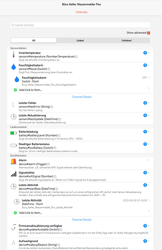

But no one of them has any channels:
Also adding is not possible, no device types are there:
The binding is installed add active and also listed.
