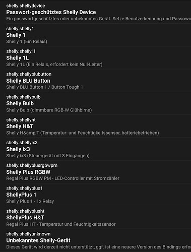

But when I tried to create a new thing the Shelly binding was not shown at all. Did anybody else experience this?
EDIT: Problem solved
Have you checked that is listet?
the upper is the offical, the unoffical is listet down.
Are you sure it is running?
Have you manual added the command in the OH console:
“feature:install openhab-transport-coap” ?
It should work fine now.

I tried again and now it works. Probably I swapped versions during copying. Thank you.
Instead I keep the tradfri-binding installed because that installs coap too.
