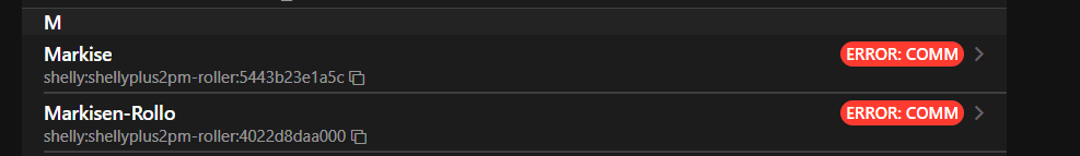

Wenn I go with the mouse over “ERROR: COMM” it says “Unerwarteter Fehler - WebSocket error”. After a while it is online again and than again “ERROR: COMM”.
I’m not sure if this is the right error message in the openhab.log:
2025-05-18 14:16:46.328 [INFO ] [b.core.io.websocket.log.LogWebSocket] - WebSocket error: java.util.concurrent.TimeoutException: Idle timeout expired: 10000/10000 ms
Not sure if this is a Shelly or Openhab problem

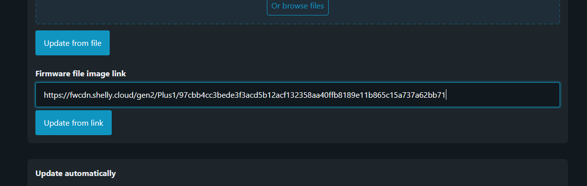

Then you go via the UI to the Shelly Plus 1, to the section setting, firmware,
and paste the line you got back with starts with “https://fwcdn…” from the browser to the field “Firmware file image link”
Press the “update from Link” button, and your shelly plus 1 will be flashed (downgraded) with the 1.5.1 version and will do a reboot.
Thats it… Have fun by doing a downgrade…

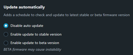

PSS: I would recommend to also flag in the Shelly the setting “not to do an autoupdate”:

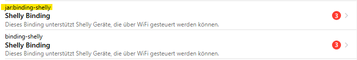

You have two binding listet in your system: the old one (4.3.5) and the new one 5.0.0
Now you can selected the new 5.0.0 binding and can add the shelly plus1 to your system.
Create all the channels in the new thing (shelly plus 1)
–>> It works (at least for me)
