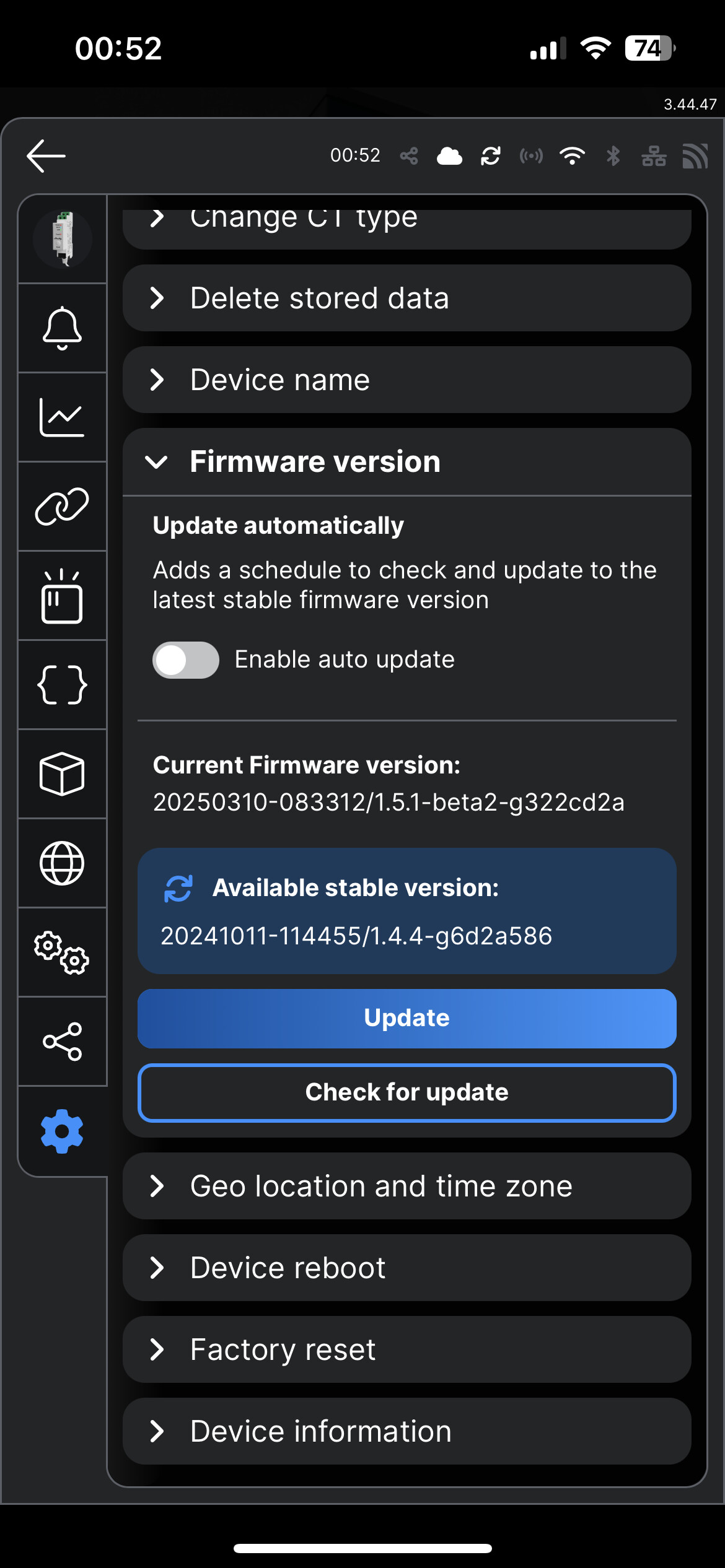

For all of us stuck with the Shelly pro3EM, today I noticed that there’s a new beta2 firmware available if you go through the local webui:
I installed it and now we wait to see if it crashes too.

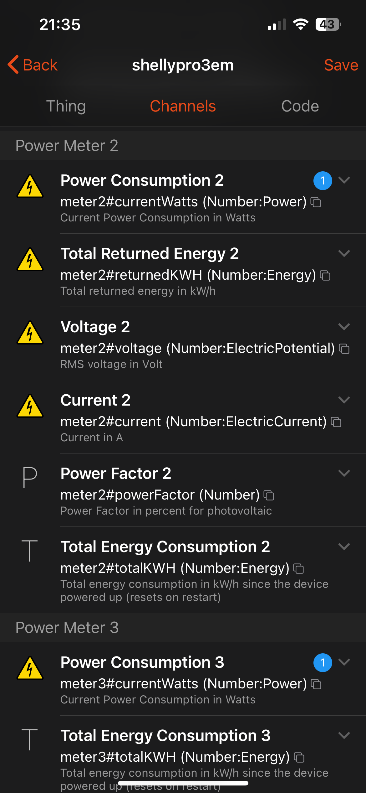

By the way, I updated to the 5.0M1 and I still lack the 3rd meter channel:
I will create a bug in GitHub, it’s so strange that it’s just the one channel missing :confused:

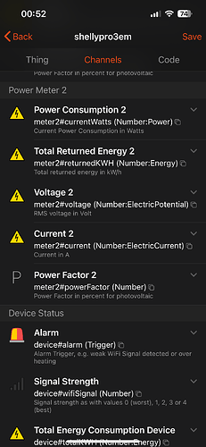

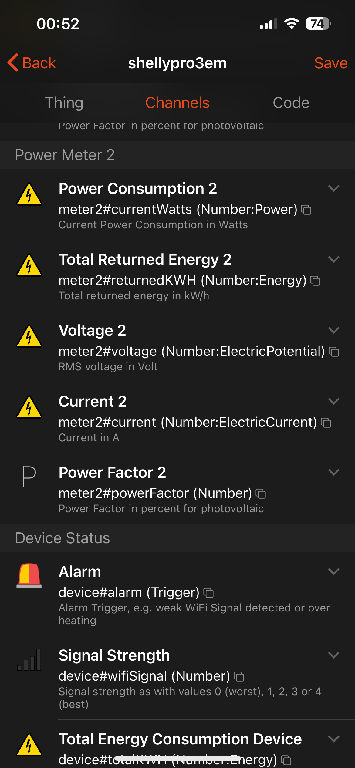

Edit:
Weird things be happening… got my brain confused with the setup of the pro3em, and thought mine should be in triphase. Once I changed to triphase I immediately recognized my error, so I changed it back. As I was curious to see if this had messed with OpenHAB, I checked the Thing and….
It’s correct now…. Not sure why but I’m not complaining.
