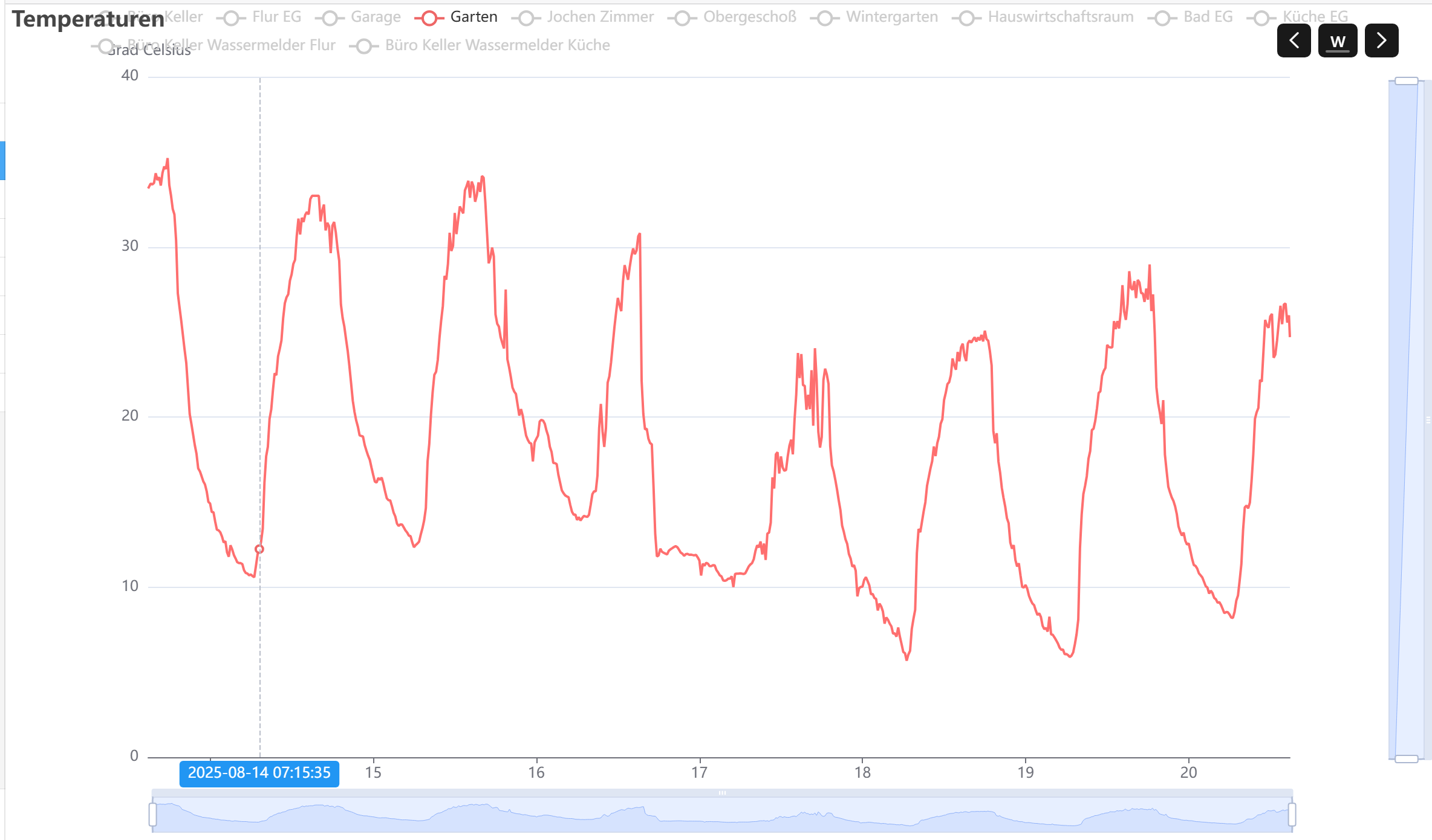

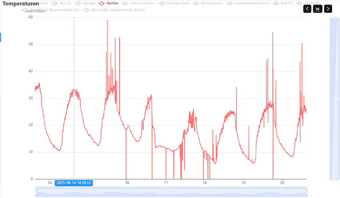

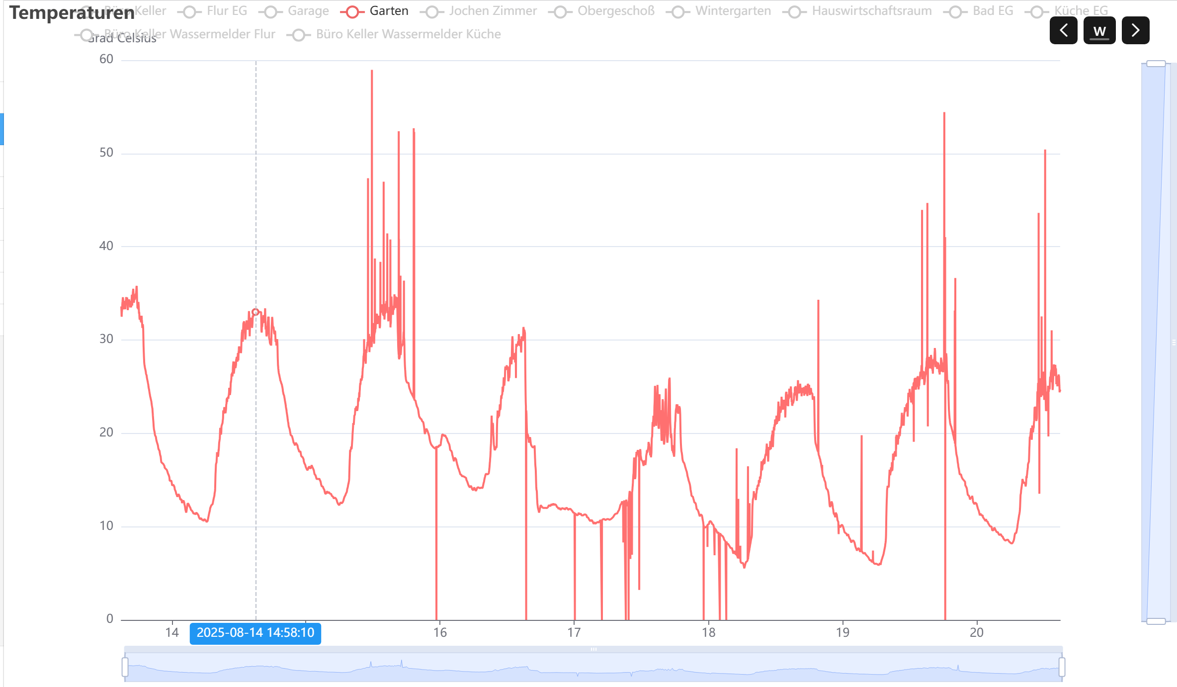

I updated one of my shelly1plus Gen3 from the latest 1.7.0-beta4 to the offical 1.7.0 (1.7.0-/20250730) now. This shelly has an AddOn Module and a temperatur/humity sensor connected.
With the beta4 everything was fine, and the sensor shown ne normal values:
Now after update to the offical 1.7.0, I have some spikes in the graph, where I have no idea were they come from:
@markus7017 : Any good hint here?

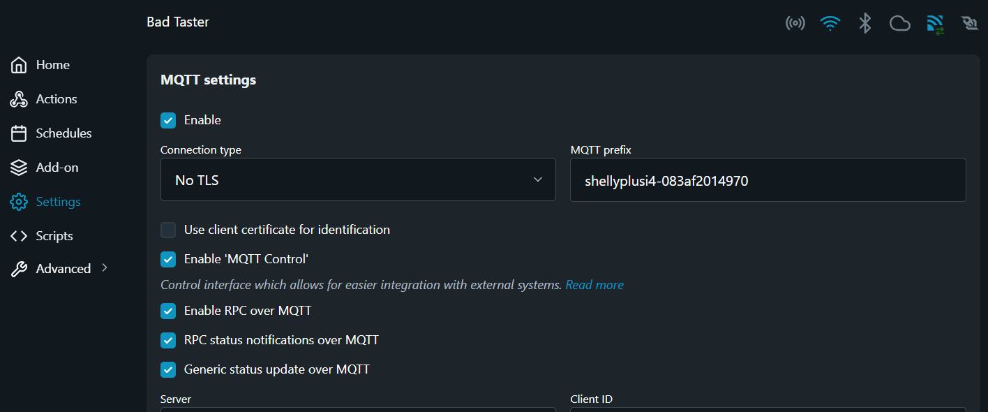

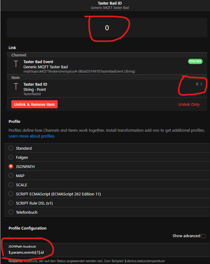

I run 15 Shelly devices with OH 5.0.1 and have the following warnings with 3 shellyplusi4. In opposite to the other Shellys these 3 communicate with MQTT.
I use the following MQTT settings on these shellyplusi4:
The following WARN messages of the 3 Shelly devices (firmware 1.7.0) are in the Log and repeat about every 30 minutes:
2025-08-22 10:46:40.136 [WARN ] [ofiles.JSonPathTransformationProfile] - Could not transform state ‘{“src”:“shellyplusi4-083af2014970”,“dst”:“shellyplusi4-083af2014970/events”,“method”:“NotifyStatus”,“params”:{“ts”:1755852400.10,“sys”:{“last_sync_ts”:1755852400}}}’ with function ‘$.params.events[:1].event’ and format ‘%s’
2025-08-22 10:46:40.137 [WARN ] [ofiles.JSonPathTransformationProfile] - Could not transform state ‘{“src”:“shellyplusi4-083af2014970”,“dst”:“shellyplusi4-083af2014970/events”,“method”:“NotifyStatus”,“params”:{“ts”:1755852400.10,“sys”:{“last_sync_ts”:1755852400}}}’ with function ‘$.params.events[:1].id’ and format ‘%s’
2025-08-22 10:46:40.149 [WARN ] [ofiles.JSonPathTransformationProfile] - Could not transform state ‘{“src”:“shellyplusi4-083af2014970”,“dst”:“shellyplusi4-083af2014970/events”,“method”:“NotifyStatus”,“params”:{“ts”:1755852400.10,“sys”:{“time”:“10:46”,“unixtime”:1755852400}}}’ with function ‘$.params.events[:1].event’ and format ‘%s’
2025-08-22 10:46:40.150 [WARN ] [ofiles.JSonPathTransformationProfile] - Could not transform state ‘{“src”:“shellyplusi4-083af2014970”,“dst”:“shellyplusi4-083af2014970/events”,“method”:“NotifyStatus”,“params”:{“ts”:1755852400.10,“sys”:{“time”:“10:46”,“unixtime”:1755852400}}}’ with function ‘$.params.events[:1].id’ and format ‘%s’
2025-08-22 10:49:41.427 [WARN ] [ofiles.JSonPathTransformationProfile] - Could not transform state ‘{“src”:“shellyplusi4-fcb467ba8b30”,“dst”:“shellyplusi4-fcb467ba8b30/events”,“method”:“NotifyStatus”,“params”:{“ts”:1755852581.38,“sys”:{“last_sync_ts”:1755852581}}}’ with function ‘$.params.events[:1].id’ and format ‘%s’
2025-08-22 10:49:41.427 [WARN ] [ofiles.JSonPathTransformationProfile] - Could not transform state ‘{“src”:“shellyplusi4-fcb467ba8b30”,“dst”:“shellyplusi4-fcb467ba8b30/events”,“method”:“NotifyStatus”,“params”:{“ts”:1755852581.38,“sys”:{“last_sync_ts”:1755852581}}}’ with function ‘$.params.events[:1].event’ and format ‘%s’
2025-08-22 10:49:41.439 [WARN ] [ofiles.JSonPathTransformationProfile] - Could not transform state ‘{“src”:“shellyplusi4-fcb467ba8b30”,“dst”:“shellyplusi4-fcb467ba8b30/events”,“method”:“NotifyStatus”,“params”:{“ts”:1755852581.38,“sys”:{“time”:“10:49”,“unixtime”:1755852581}}}’ with function ‘$.params.events[:1].id’ and format ‘%s’
2025-08-22 10:49:41.443 [WARN ] [ofiles.JSonPathTransformationProfile] - Could not transform state ‘{“src”:“shellyplusi4-fcb467ba8b30”,“dst”:“shellyplusi4-fcb467ba8b30/events”,“method”:“NotifyStatus”,“params”:{“ts”:1755852581.38,“sys”:{“time”:“10:49”,“unixtime”:1755852581}}}’ with function ‘$.params.events[:1].event’ and format ‘%s’
2025-08-22 11:12:30.455 [WARN ] [ofiles.JSonPathTransformationProfile] - Could not transform state ‘{“src”:“shellyplusi4-fcb467bb19cc”,“dst”:“shellyplusi4-fcb467bb19cc/events”,“method”:“NotifyStatus”,“params”:{“ts”:1755853950.41,“sys”:{“last_sync_ts”:1755853950}}}’ with function ‘$.params.events[:1].id’ and format ‘%s’
2025-08-22 11:12:30.456 [WARN ] [ofiles.JSonPathTransformationProfile] - Could not transform state ‘{“src”:“shellyplusi4-fcb467bb19cc”,“dst”:“shellyplusi4-fcb467bb19cc/events”,“method”:“NotifyStatus”,“params”:{“ts”:1755853950.41,“sys”:{“last_sync_ts”:1755853950}}}’ with function ‘$.params.events[:1].event’ and format ‘%s’
2025-08-22 11:12:30.465 [WARN ] [ofiles.JSonPathTransformationProfile] - Could not transform state ‘{“src”:“shellyplusi4-fcb467bb19cc”,“dst”:“shellyplusi4-fcb467bb19cc/events”,“method”:“NotifyStatus”,“params”:{“ts”:1755853950.41,“sys”:{“time”:“11:12”,“unixtime”:1755853950}}}’ with function ‘$.params.events[:1].id’ and format ‘%s’
2025-08-22 11:12:30.466 [WARN ] [ofiles.JSonPathTransformationProfile] - Could not transform state ‘{“src”:“shellyplusi4-fcb467bb19cc”,“dst”:“shellyplusi4-fcb467bb19cc/events”,“method”:“NotifyStatus”,“params”:{“ts”:1755853950.41,“sys”:{“time”:“11:12”,“unixtime”:1755853950}}}’ with function ‘$.params.events[:1].event’ and format ‘%s’
I’m not sure, if I need to adjust the settings … or I need to live with the warnings. Your advice would be appreciated!

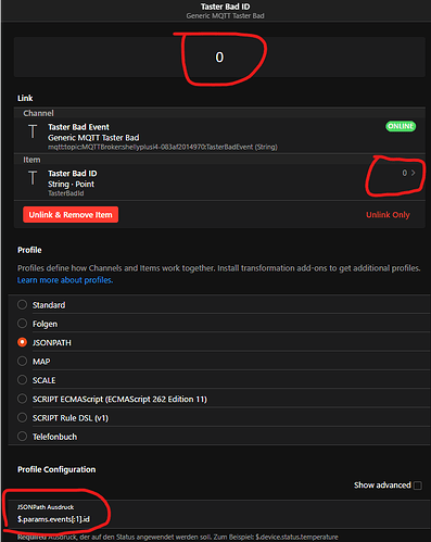

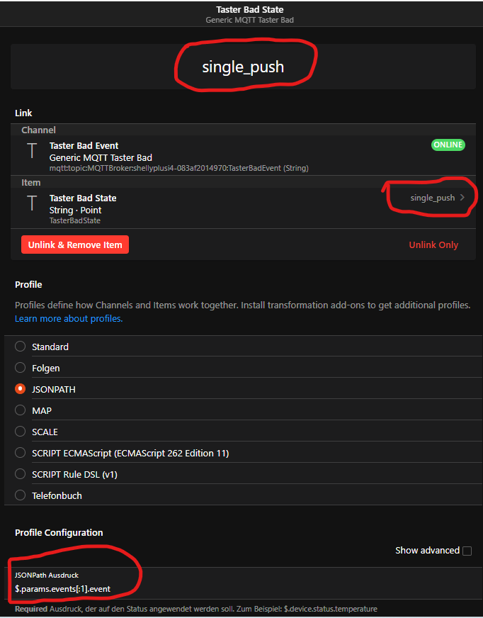

obviously the JSON transformation you build does not work anymore, you need to check your transform
please try switching to the DEV build
For me the latest DEV binding fixed my issues with the Mini PM Gen3 websocket errors.
The JSONPath Transform for the commands “single_push” on key “0” work
… but not for other notifications.
How can I eliminate the WARN messages for other notifications from the log?
