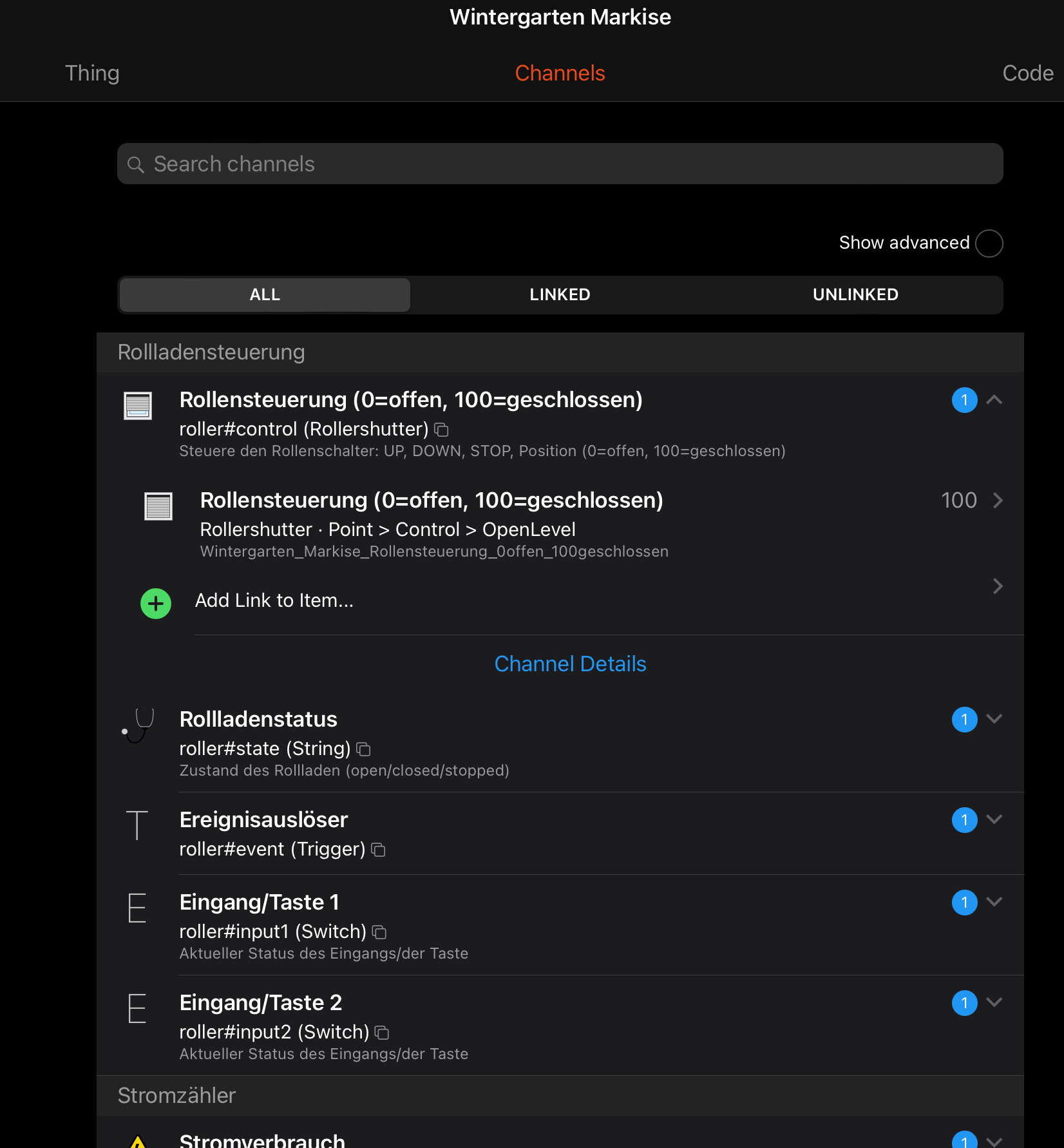

There is also a native position channel when you activate “advanced channels”
The DEV version had not been installed. I deleted the manually detected shelly device, installed the above DEV Version and did a scan. The scan detected the correct device “shellyazplug”. Thank you @markus7017 for your advice!
I just realized that after cabibration the position channel appeared :sweat_smile:

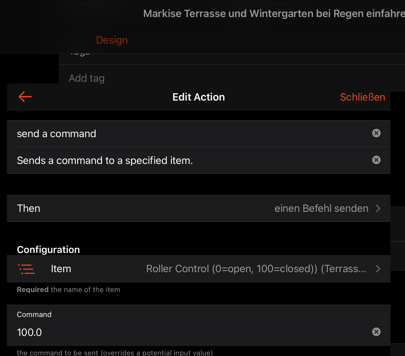

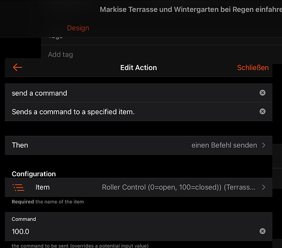

I‘m using also several Shelly 2PM Gen3 in Rollo Mode.
On my OH 5.0.3 with the prod Shelly binding I have as usual a channel for the position from 0-100 %
I trigger this channel, e.g. when it starts to rain with a rule an send the command to the Shelly, like here:
