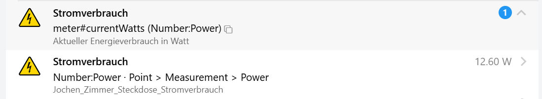

OH5.1 and Shelly PlugS GEN3 - Powervalue not more updated.
Hello @markus7017 : Today I found out, that my Shelly PlugS GEN3, with FW 1.7.1
was not more able to report the current Power value to my OH 5.1 system.
The Binding which is in use is the production binding.
What was working?
The Shelly was active and I was able to log on him via WEB-UI
The value for power was shown, and I was able to switch hin on/off
On my OH5.1 I was also able to switch him on/off
The channel āStromverbrauchā was not more updated.
After a setting the Item offline and Online, the issue was gone and the current power was shown (see picture)
I have two other OH 5.1 systems with the same configuration, on that value was NOT offline. On thoose system the value was shown.
Not a big stuff, but I switch the Item on and off based on the power value automaticly, and when the value is not show, it will be not switch on and off.

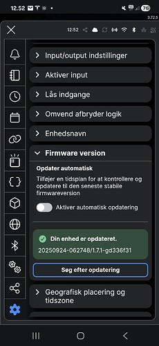

There is no new release. The switch is still on.
I have no idea where to look for beta firmwares.
