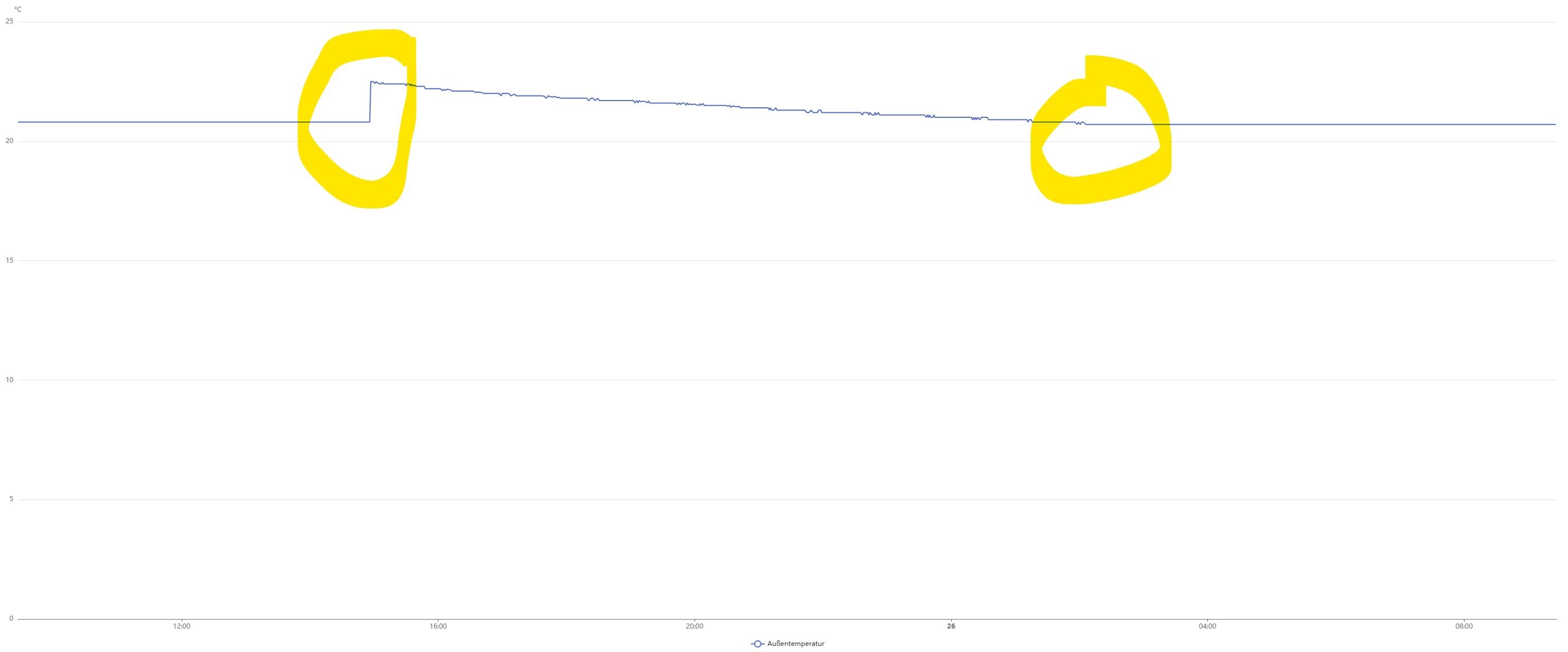

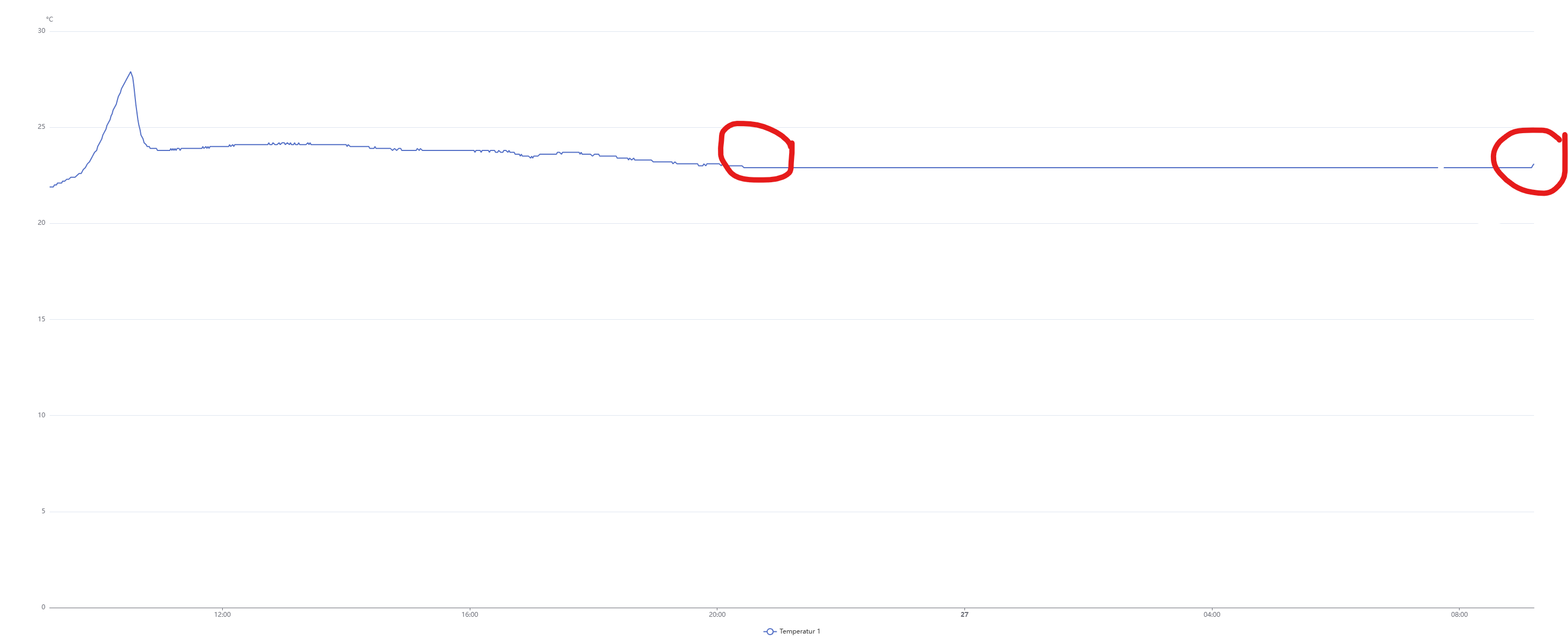

As you can see, the most of the channels are also missing in the reporting. Only the heartbeat is there but in 120sec timing....
Maybe this helps here somehow for debugging…

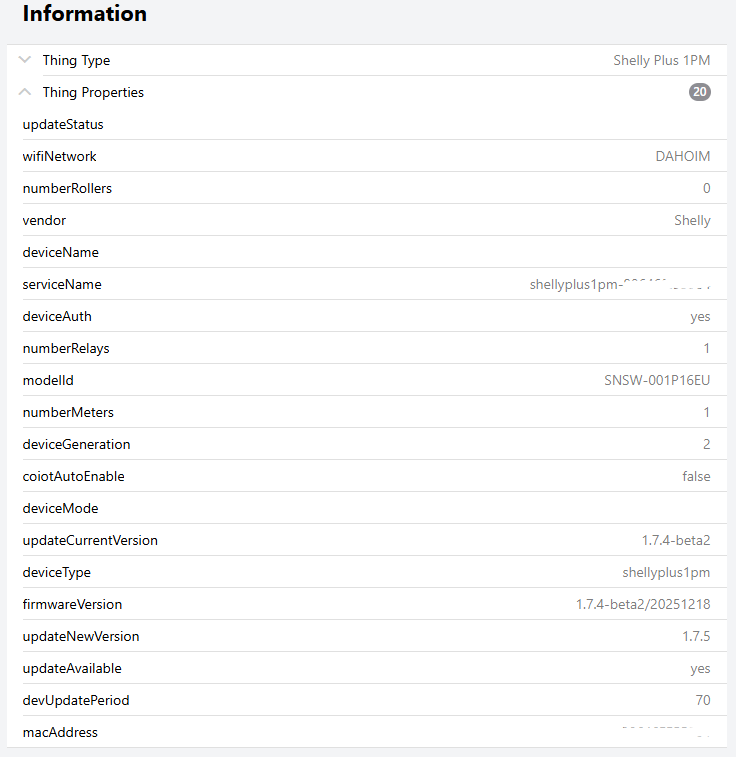

This 1PM has an AddOn Module attached with should give me the temperature.
Yesterday I noticed, that it stops reporting. The I restarted the thing. (first yellow mark)
The it works, but in the the middle of the night it seems to be stoped addtional. (secound yellow mark)
So very interesting …
→ I deleted the thing and created them new.
After generation the things become online, but has not reported any values (heartbeat) for some minutes.
→ Then I was bringing the Thing offline and online in the OH and from this moment onward it reports all values as it should be:
