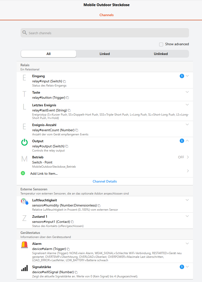

On one Shelly 1 the channel look a little funny but without a problem :slight_smile:
  • Zustand
  • Luftfeuchtigkeit
