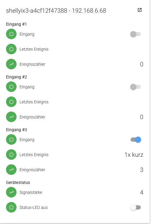

I tried the latest DEV build with ix3 running 1.7 and 1.8, it worked in both modes.
You need to change the button type to Momentary Switch, you have selected toggle mode
ā€œbtn_typeā€:ā€œtoggleā€
Go to the WebUI and select the correct button type for each channel.

I’ve only the first channel configured as toggle because I’ve a switch connected to it, channel 2 and 3 are correctly configured as momentary, I’ve tried to remove the thing and set it up again, as you can see in the attached log at the begininng the status is reported correctly but after this no more updates.
I’ve checked and on MQTT the status is correctly reported from the i3…
openhab.log (23.3 KB)
I see that you are not running the latest DEV build, please update
restart OH and do nothing
after 60sec the channel cache gets enable, just wait
and then you should see every 15s a CoAP message
If this is not working something is wrong with the device communication.
I attached the same switch to 2 havong a momentary switch
each time I press the button both inputs get updated, event count increases
However, I notice that it takes 3sec, but that’s when the device sends the CoAP message
I’ll contact Alterco and check if this might be a firmware issue, other devices are much faster
Updated to the last DEV build, nothing changed for me…
Shelly 1,2,2.5,EM, RGBW2, GAS correctly reporting but not the i3
