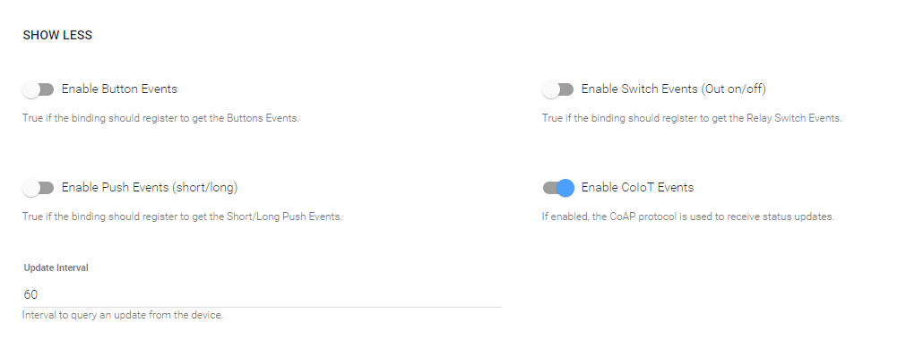

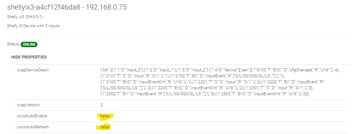

Maybe a stupid question, but I’ve noticed in the things properties those two ā€œfalseā€ under coiotAutoEnable and coiotAutoRrfesh, could they be related in some way with the issue?
In the thing configuration the Events are correctly enabled.

thanks for your efforts in the Shelly binding.
Which FW version did you test, lately?
I assume 1.8.2?
I tested the version from http://archive.shelly-faq.de/version/v1.8.2/SHSW-1.zip without resulting in acceptable delays / GUI reactions on toggling buttons.
openHAB core was on 2.5.9 snapshot with your latest Shelly Binding DEV build.
What is for the moment the best / fastest option for an production system?
Disabling CoIoT/CoAP and using Action Callback URLs instead?
