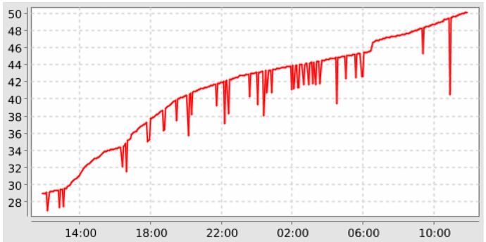

i have a problem with the shelly bindng and the Shelly 3EM with “device_accumulatedWTotal”.
Sometimes the binding give me the Total without “meter1_totalKWH”.
shelly_shellyem3_device_accumulatedWTotal = 37.86
shelly_shellyem3_meter1_totalKWH = 12.055
shelly_shellyem3_meter2_totalKWH = 6.325
shelly_shellyem3_meter3_totalKWH = 31.535
In the graph you can see that this problem comes at different times approx over 30 times a day.
accumulatedWTotal

i see the same problem…
i have a trace log for you:
openhab.log (19.2 KB)
you see the lines:
Channel device#accumulatedWTotal updated with 189.695 kWh
Channel device#accumulatedWTotal updated with 227.669 kWh
…the second value is the correct one…
