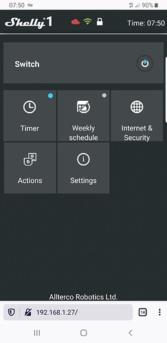

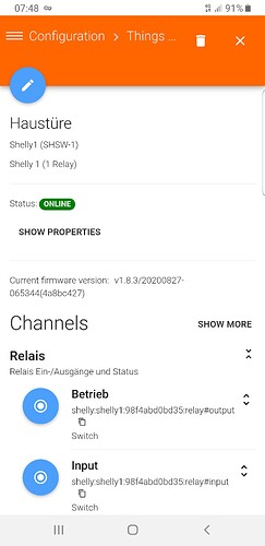

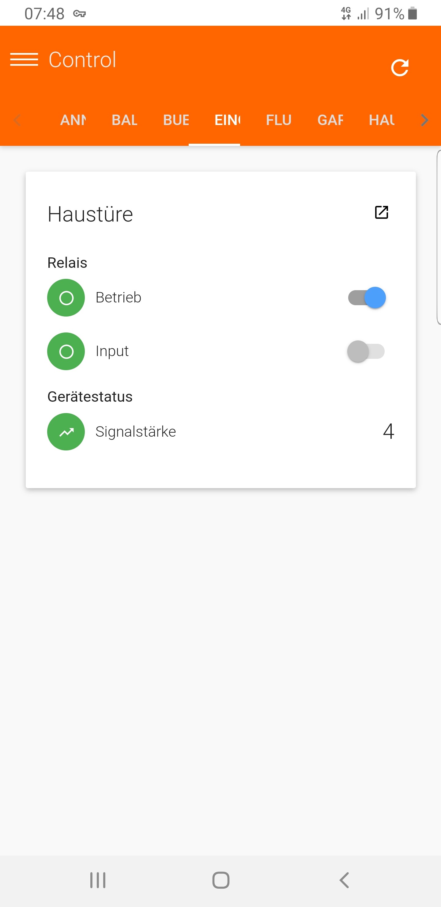

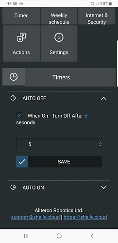

Hello Markus7017.
Since the update to 2.5.8-1 an the attched SHelly binding, I have th eissue, that under the Android UI, an d other UI’s my shelly1’s which have the feature Auto Off for the Relais e.g. als openener fo the door, keeps the visible switch in the UI’s always on. In passed the UI was showing me 5sec the “On” and the after the 5sec it was shoiung me off. The shelly1 runs with 1.8.3, and the OH with 2.5.8-1.
With clean the cache an a reboot i coul dnot solve the issue.
Any idea?
BR
Jochen
PS: From the shelly forum, a other user “funkenwerner” is also reporting the issue.
