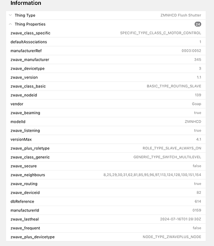

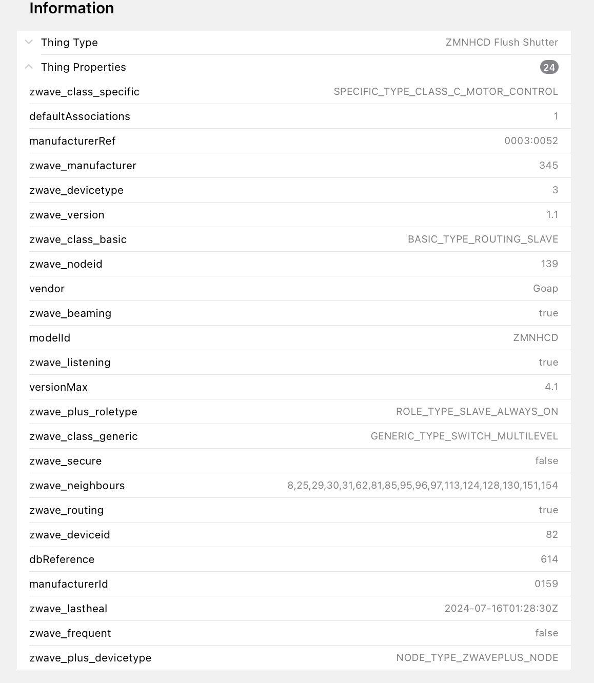

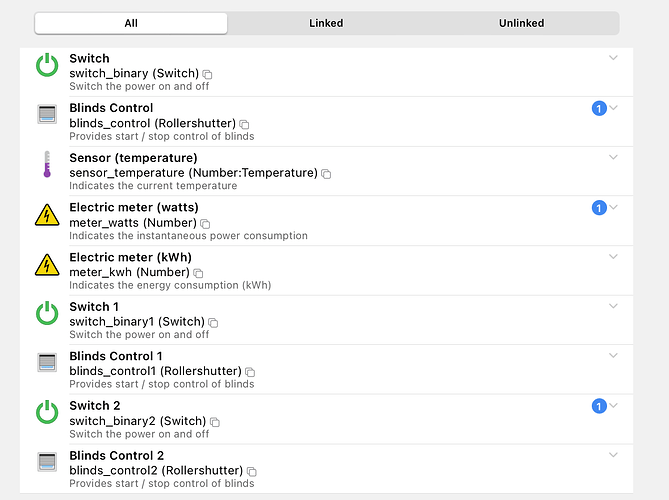

Hi, I recently bought a Shelly Wave Shutter to replace my old (buggy) Qubino Flush Shutter modules. After inclusion the module appears as a dimmer (type 1), not as a shutter (type 3). The strange thing is, that the info in openhab says type 3 correctly, but all endpoints 0/1/2 are all dimmers, not blinds_control. Also, the endpoints do not expose switch_binary like they did for the Qubino modules. I checked in ZWave JS UI, and in there the Shelly Wave Shutter is identified as a shutter, not as a dimmer, and it is type 3.
I have attached some screenshots about the openhab info for the modules and the channels exposed, as well as the same info from ZWave JS UI. I added as well the XML. I may check tomorrow in the DB what is in there, maybe this is a bug in there ?
