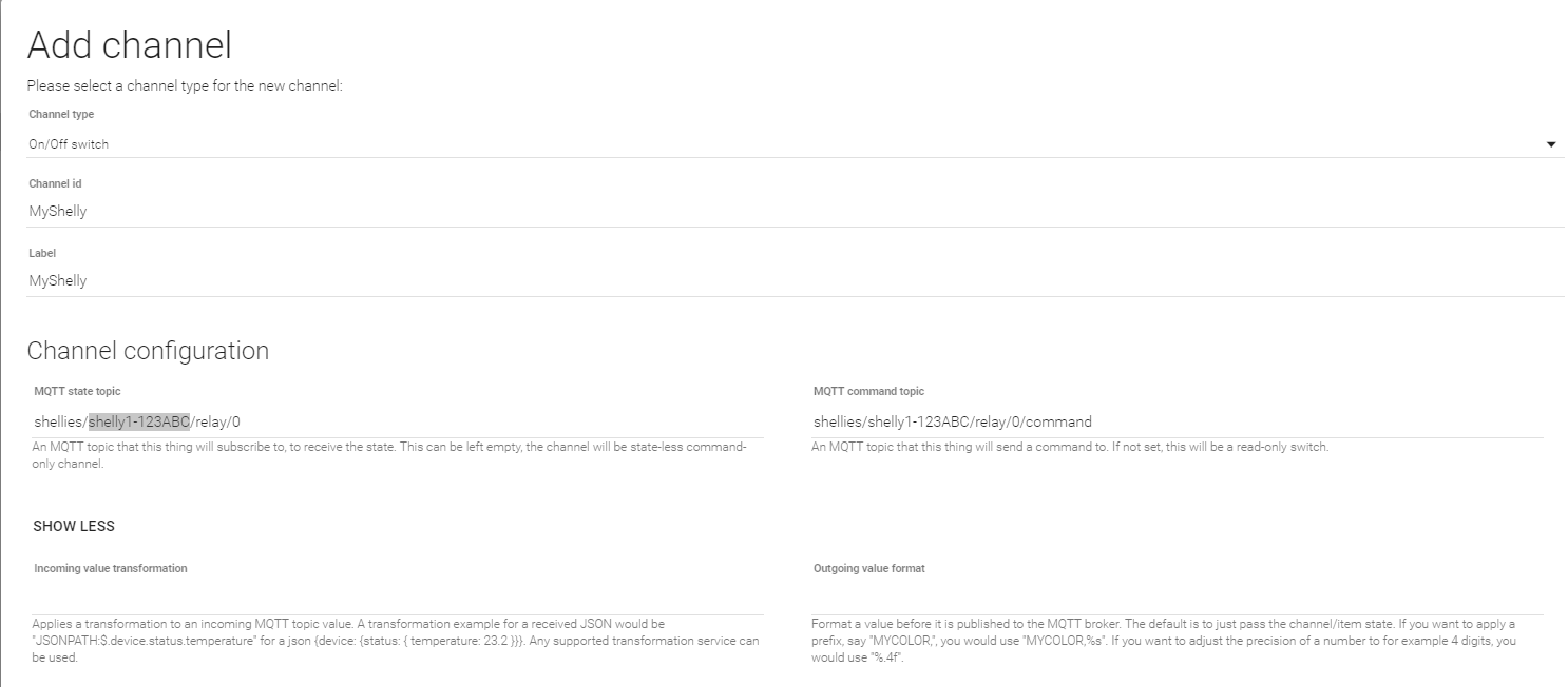

Just a quick reference: Using the original firmware, you can control your shelly 1 switch with the new mqtt 2.4.0 binding as follows:

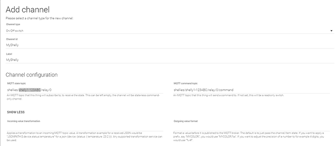

Create a mqtt broker, providing your broker’s data, and create a MQTT Thing. In the MQTT Thing configuration, create a new channel with the followin Data:
  • Channel type: On/Off switch
  • Channel ID, Label: As you like
  • Channel configuration:
    • MQTT state topic: shellies/shelly1-123ABC/relay/0
    • MQTT command topic: shellies/shelly1-123ABC/relay/0/command

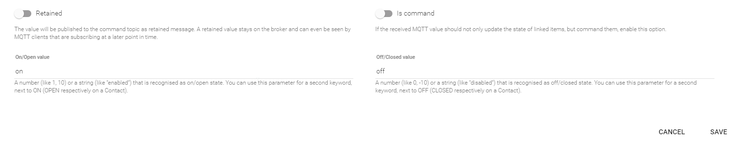

  • Show More:
    • On/Open value: on
    • Off/Closed value: off
(replacing shelly1-123ABC by your shelly’s ID)
You can then use the channel to link to a Switch item to control your shelly.

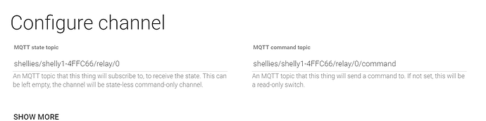

Sorry, this string in the THING file cause Bridge not start (not visible in Paper UI)
[ stateTopic=“shellies/shelly1-4FFC66/online/0”, commandTopic=“shellies/shelly1-4FFC66/online/0/command”, on=“on” off=“off”]
Instead this is fully operational and Paper UI show both Bridge and thing channel configuration
[ stateTopic=“shellies/shelly1-4FFC66/relay/0”, commandTopic=“shellies/shelly1-4FFC66/relay/0/command”]
So it seems I’m wrong with the aliases configuration at the and (on and off)…

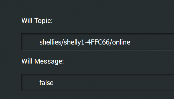

In my Shelly panel configuration I got this
Does it misleading with the OpenHab configuration files we shared ?
I regulary see value in transit when I operate from the phisical button or virtual Shelly app so MQTT is fully working I assume
Just checked mine from the phone and it shows the same message in the “Will Topic”, but that doesn’t change regardless of if I turn the Shelly off via the Shelly web app or OH switch.

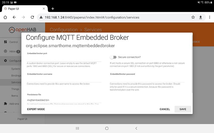

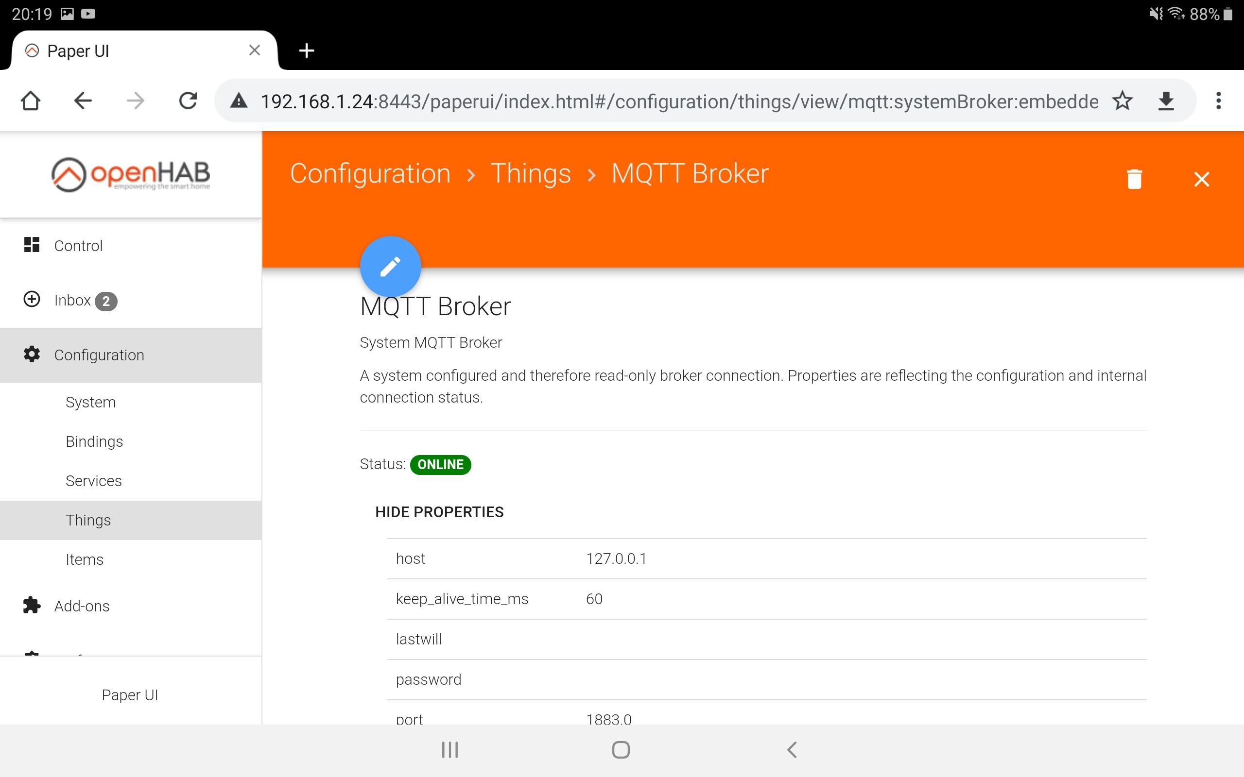

Just checked the last (?) thing, I just wanted to try adding the port to the Bridge configuration
It’s works now as expected!
By the way, port number is the standard (1883) but it seems configuration need it anyway
Don’t know if is normal behaviour or if it has dignity to pay attention to it by the OH mantainers

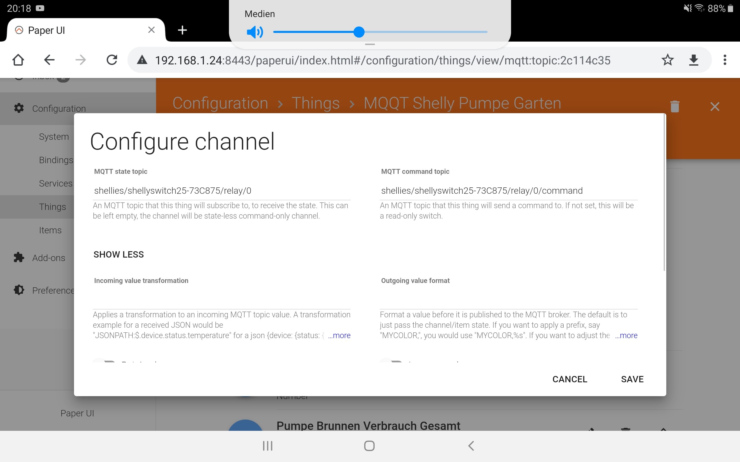

For me it works as follow:
Things:
Thing mqtt:topic:OG1_ba_li_schalter "OG1_ba_li_schalter" (mqtt:broker:mosquitto) {
        Channels:
        Type string : online    "Online"        [ stateTopic="shellies/shellyswitch25-xxx13/online" ]
        Type switch : power1    "Power1"        [ stateTopic="shellies/shellyswitch25-xxx13/relay/0", on="on", off="off", commandTopic="shellies/shellyswitch25-xxx13/relay/0/command", on="on", off="off"]
        Type switch : power2    "Power2"        [ stateTopic="shellies/shellyswitch25-xxx13/relay/1", on="on", off="off", commandTopic="shellies/shellyswitch25-xxx13/relay/1/command", on="on", off="off"]

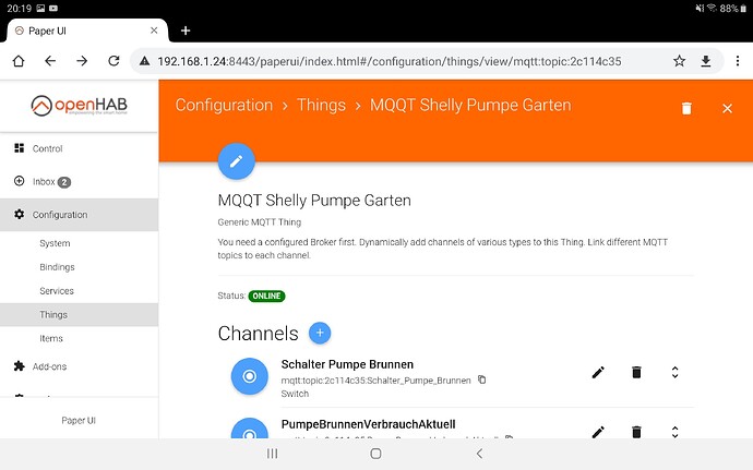

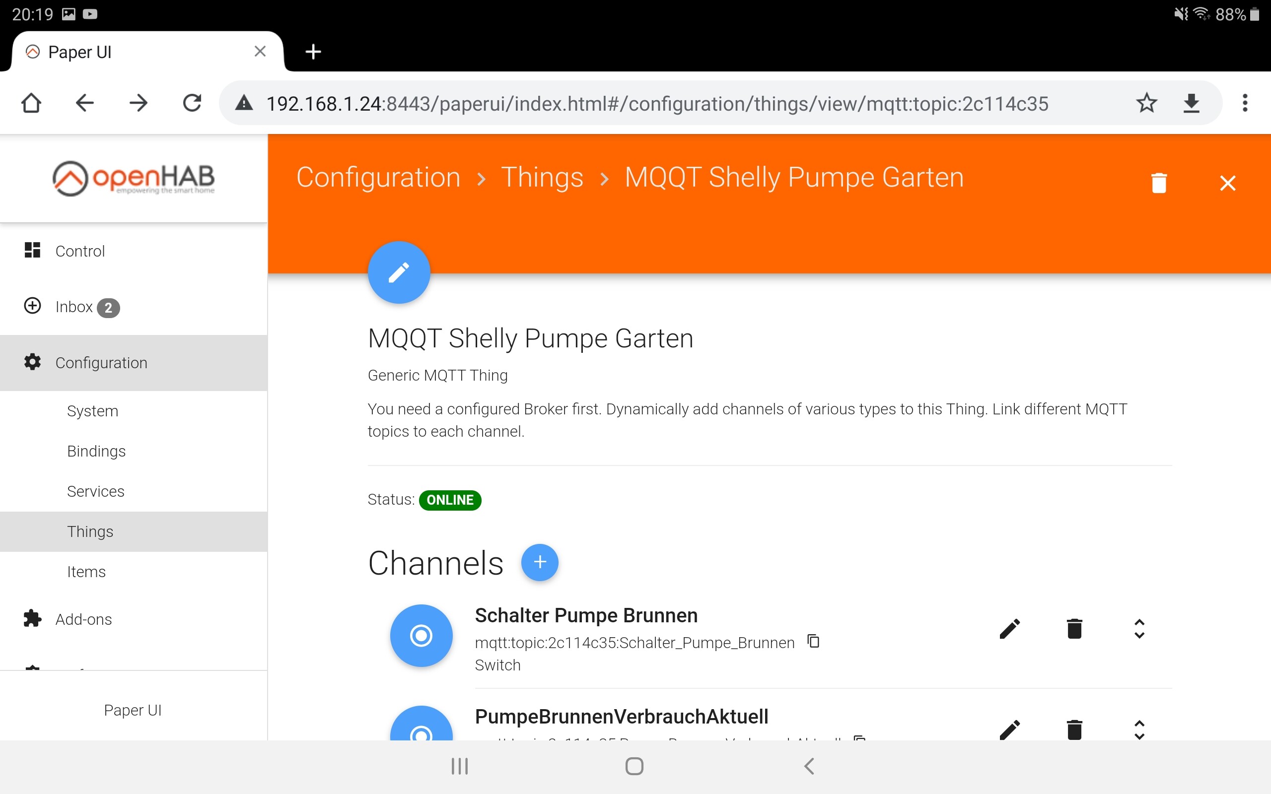

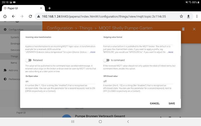

attached are screenshots of my openHAB configuration (in PaperUI - requires OpenHAB 2.4).
Unfortunately I cannot provide screenshots of my Shelley config now, my garden water equipment is already switched off for winter. Hope that the information is nevertheless helpful!
