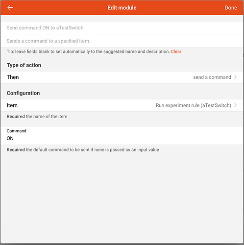

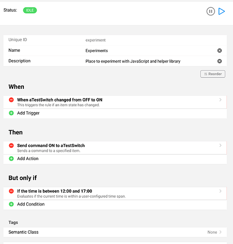

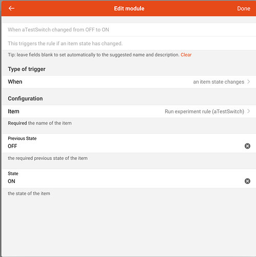

But in JSONDB rules you wouldn’t even need any code.
You can create the changed trigger with the from OFF to ON. Add a but only if conditional for “a certain time of day” and define the start and end time. And then use a send a command action.
The code view looks like
triggers:
  - id: "2"
    configuration:
      previousState: OFF
      state: ON
      itemName: aTestSwitch
conditions:
  - id: "1"
    configuration:
      startTime: 12:00
      endTime: 17:00
    type: core.TimeOfDayCondition
actions:
  - id: "3"
    configuration:
      command: ON
    type: core.ItemCommandAction
Obviously you would use different Items. But for a simple rule like that you don’t even need to mess with Blockly level code. In my mind, this lowers the barrier to entry for “non-technical users” significantly.
