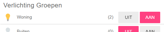

In my sitemap, this is nicely shown as button, and a nice effect was that I saw the number of lights that were ON.:
Switch item=LightsWO label="Woning" mappings=[OFF=Uit, ON=Aan]
Screenshot 2022-01-10 142115
MainUI
I’m trying now the same in the mainUI, but instead of the number, i just show me the status? Any idea how I can get the same effect as with the sitemap? I tried with state or displayState, but no luck. :blush:
