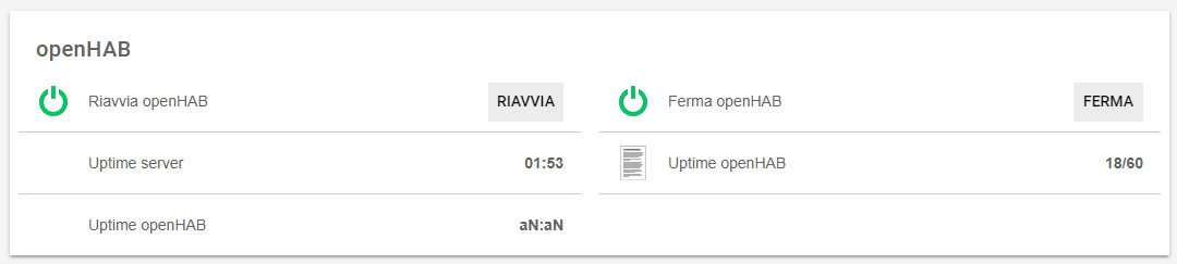

hello, i’ve tried to make work Uptime openHAB but doesn’t work.
i ha ve this result.
can anyone give some minutes of his time to help me?

this is the only openhab.log info that could help:
2018-10-08 13:07:29.674 [WARN ] [rthome.model.script.actions.BusEvent] - Cannot convert '798/60' to a state type which item 'System_openHAB_Uptime' accepts: [DecimalType, QuantityType, UnDefType].
thanks a lot
echo $UPTIME/60 returns a String with the number and /60 attached at the end
Therefore the transformation fails
divide by 60 inside the transformation instead
bc returned an error because it is not installed
bc stands for basic calculator, a command line calculator tool
Install it on your system. then it should work without modification. don’t forget to add the | bc to the end of the last line of the sh script
