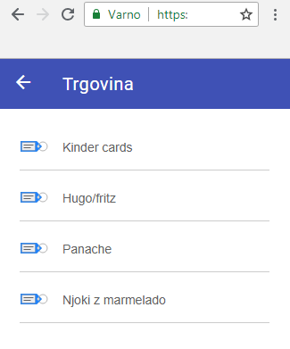

And my CSS makes it look like native OpenHAB sitemap items as well:
So I now have my shopping list from Wunderlist within OpenHAB to be shared with my family. Unfortunately, this site only renders in browser and not in the Android app. Any ideas why?
