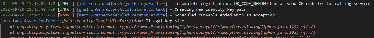

Hi Thank you for the binding.This would make it so much easier for my openHab running in a docker container.
However sadly I was not able to get it working.
Added a new landline account as follows:
Put in number+capcha as described → get the call put in pin number and saved.
I get following Error:
Same if I add the thing within the .things-file.
So I tried linked device (used my landline on an old phone to create the signal account).
If scan the qr-code in openHab I get the error “No device found” within my signal app.
This also happens if I try to link my main mobile account (not the landline).
Linking the accounts on the windows app works without a problem.
could this be a location error? I’m from Austria..
Thanks for any help!
Just noticed i get the “Illegal key size” error also when trying the linked device:

Hello @dhbl,
I think your issue is related to this.
Please ensure that you pass the CRYPTO_POLICY argument as stated here.
(If you get others issues after fixing the crypto one, you may have to delete the USERDATA/signal folder, and process with another registration, to get rid of a bad initialization)
