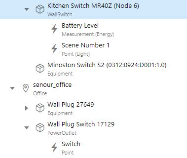

Here’s what it looks like from the semantic model:

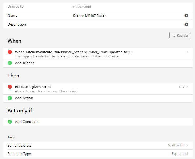

My rule design looks like this (and is based on the topic posted here: Openhab 3 Aeotec Wallmote Zwave button to control other devices - Best practice
I’ve tried variations on the scene value, including nothing (so just item being updated), to 1, to ON, to DOWN.
And the script simply doesn’t matter because I don’t think it’s executing. Right now, it looks like this:
events.sendCommand('WallPlugSwitch17129_Switch', '1');

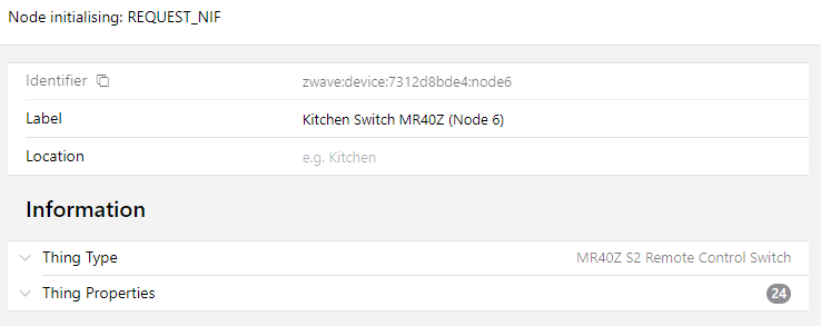

Which means that your device is in the database, but only if you are on a version more recent than 2022-09-11. You say you’re still using 3.3 so your version of the binding doesn’t have the information for your device. You can verify this by looking at the thing details for the device. If the binding actually recognizes the device then you should have a human readable label in the information section like this:
If it just says something like 0924:D001 then the your device cannot be found by that version of the binding and no sensible communication between the device and OH will be possible.

I worked through this in a different thread (Minoston S2 Remote Control Switch MR40Z), and used the bundle:update command, and it’s been recognized.

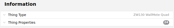

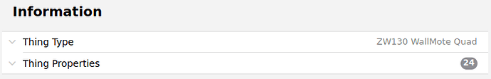

Excellent, then, the next thing to check is that it’s been fully initialized. Your device is a battery operated device and sometimes(frequently?) they don’t finish the pairing procedure during the first inclusion and you have to wake them up many times to finish the procedure.
Check that your device shows all the options at the bottom of the thing page like this:

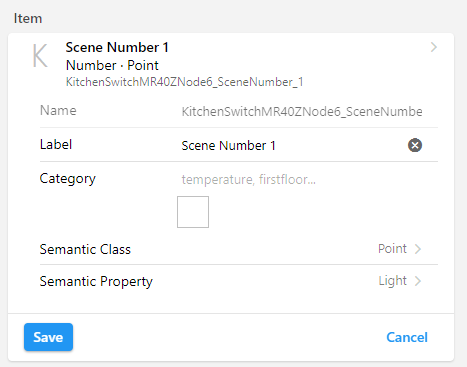

Are you sure you have linked the KitchenSwitchMR40ZNode6_SceneNumber_1 device to the correct channel and that this item is the correct type (likely a Number Item)?
That, TBH, I’m not completely certain of.
Through trial and error, I wonder if this could be part of the issue? There are two things linked here.
Talking this through with you was very helpful. There’s definitely something wrong with Scene 1. I created a Scene 2, and I’m getting the proper log events and managed to turn the switch on!

Yes, this is a problem. You would normally want an Item to represent only one channel, one device.
(There are advanced reasons to bend that rule of thumb which is why multiple links are allowed - you don’t need to be going there)
