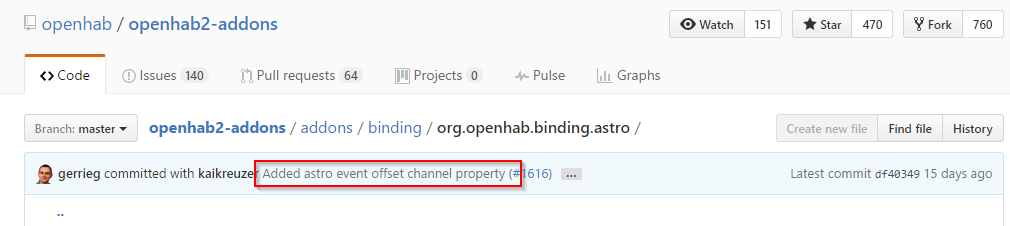

Hi all,
I see there has been an update which includes the offset functionality
The information is here.
If possible, could anyone post an example of the channel using the offset?
