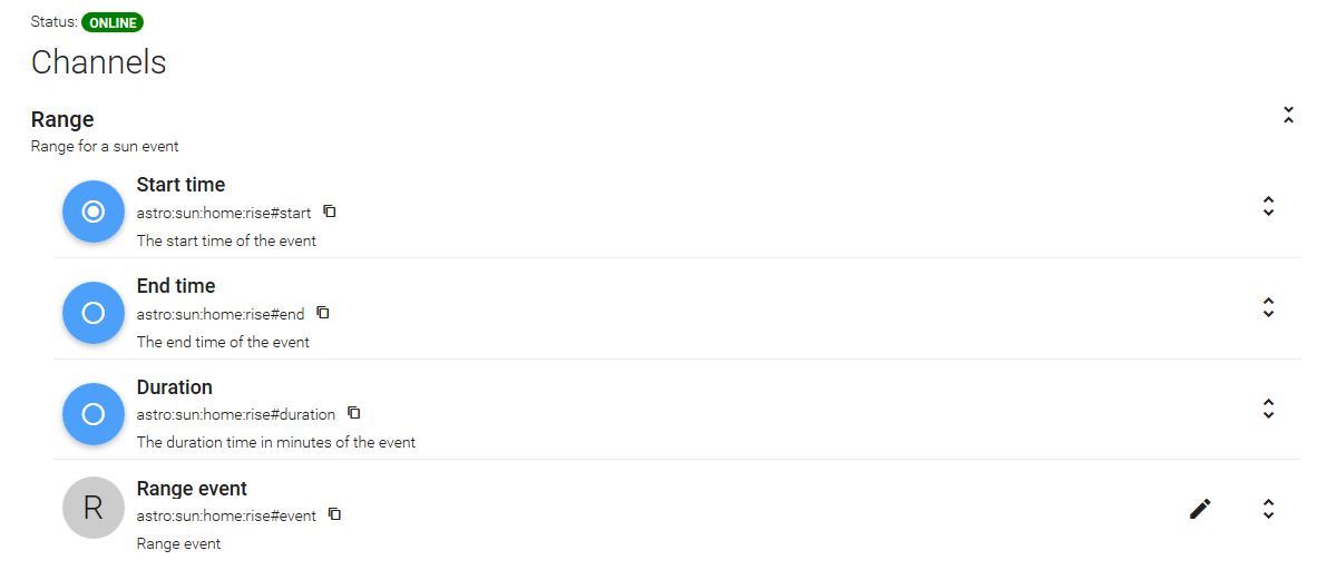

Simply turn on at sunrise, turn off at sunset in openhab2
PaperUI → Configuration → Things → select Astro sun data channel and fill in your offset value under “Range event”

Oddly though, I can’t see the offset option in Paper UI (using snapshot from 10th Feb), just start, end and duration
It’s called “Range Event”, not “Offset” or something like that …
