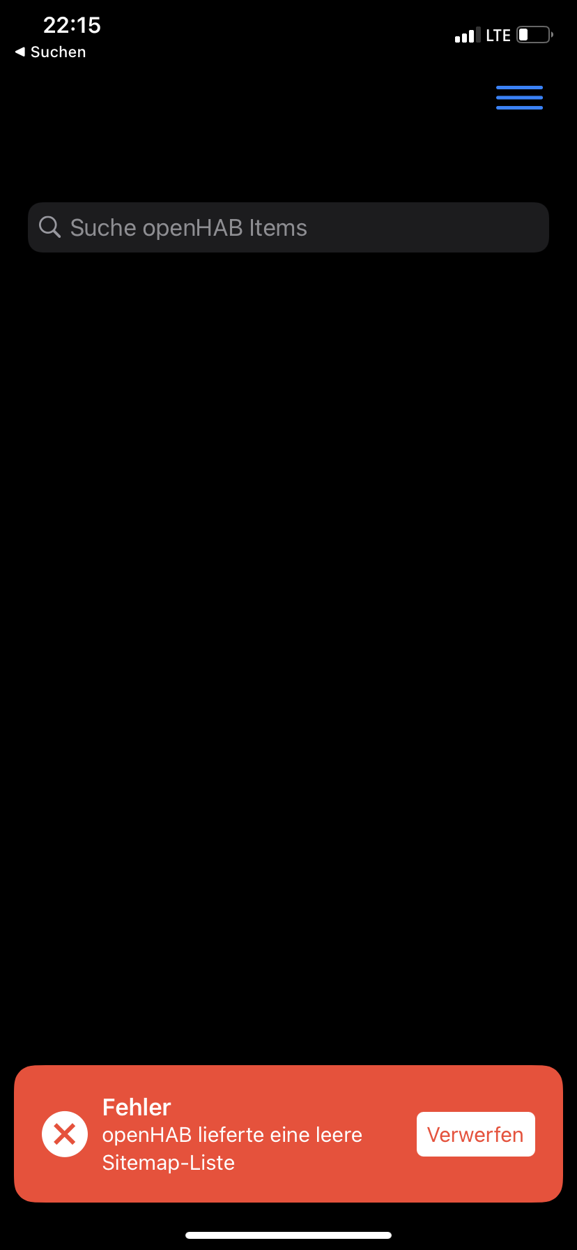

I can use it fine when connected to my wifi but when i disable WiFi and try it over the myopenhab cloud it responds:
OH delivers an empty sitemap list

i tried accessing via the iPhone app.

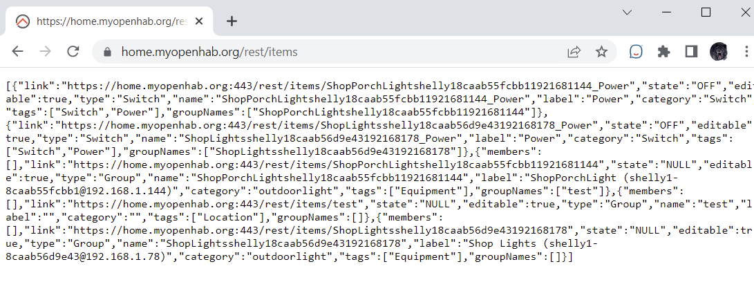

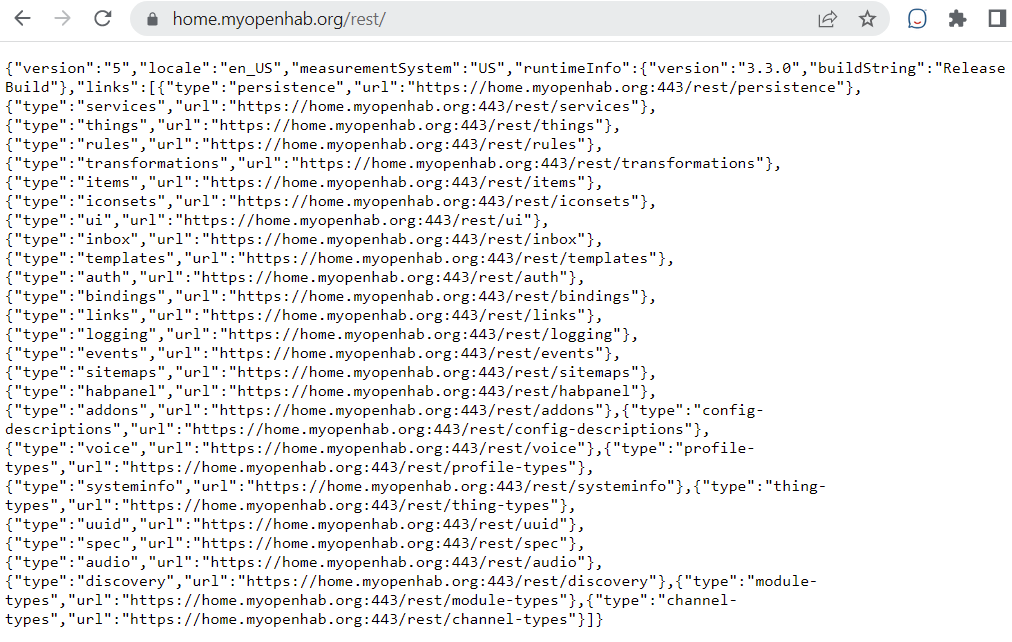

I don’t get the /rest/sitemaps over OH cloud but /rest/ and /rest/items show fine. It’s just something about getting /rest/sitemaps but if I try it locally, it works fine.

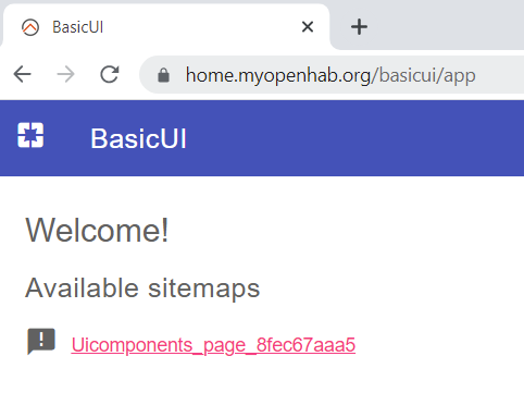

Try accessing your sitemap directly in the browser through myopenhab: https://home.myopenhab.org/basicui/app.
I’m curious if it’ll work or not.
That does but then clicking it just gives me a blank page

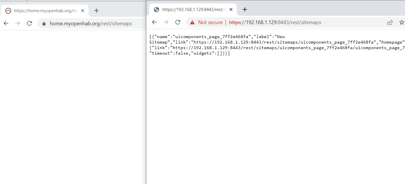

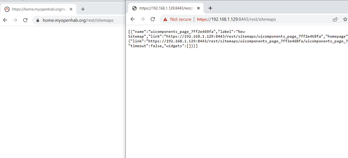

Also, what happens if you go here:
https://home.myopenhab.org/rest/sitemaps
I get the following:
[{"name":"default","label":"Home","link":"https://home.myopenhab.org:443/rest/sitemaps/default","homepage":{"link":"https://home.myopenhab.org:443/rest/sitemaps/default/default","leaf":false,"timeout":false,"widgets":[]}}]
So I built it via the UI. Works locally with the app fine. But if I try https://home.myopenhab.org/rest/sitemaps it returns nada. Shows it locally though so maybe something around the ui components page or something with OH cloud? My OH2 is textual and it works fine. Here’s an image where I get nothing over OH cloud but locally it works. Same with over 8080
