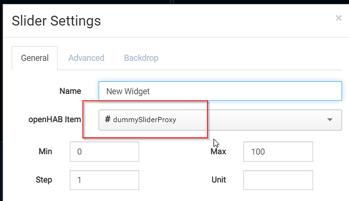

The habpanel’s standard slider and my configuration:
The screen record:
((click for play))
setpointissue3
Thats all standard stuff which I use, just added by few clicks. Am I doing something wrong?

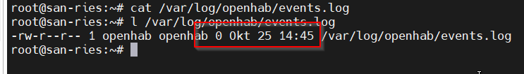

No it isn’t. That’s a separate log file to openhab.log where your rule makes its entries.
Nope, I always check both at the same time:
As you can see… empty since the first install of openHAB:
Okay, then your UI is totally broken and never sends any commands to openHAB, and openHAB itself is totally broken and never logs any Item state changes either.
Alternatively, there’s something wrong with your logging.
